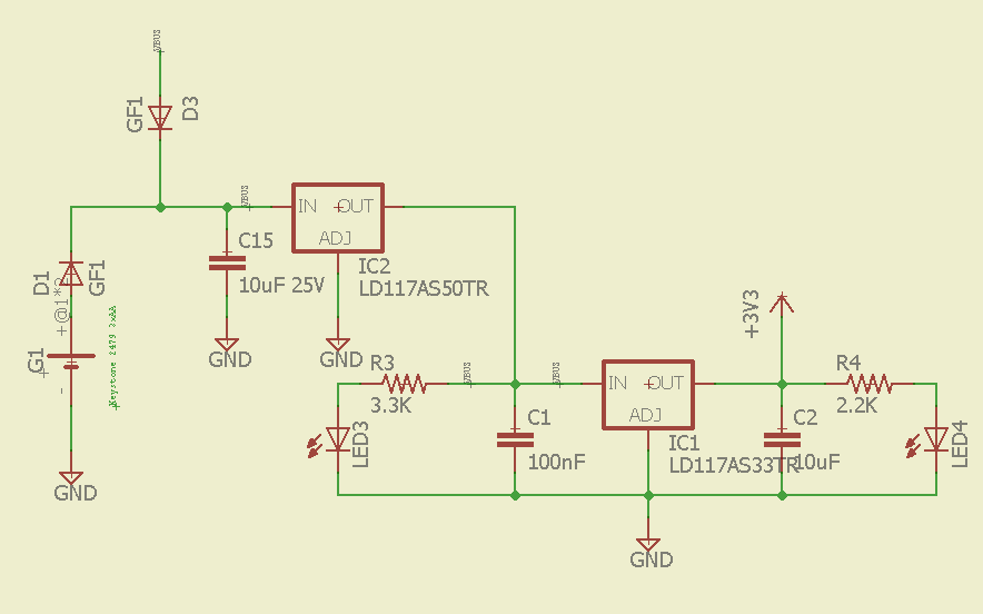

I am building a board using this MCU and I'm wondering where I can get some information on the USB schematics. Reading the data sheet somewhat helped, but didn't exactly answer my question.
I would like the ability to power the board from USB, make programming / MCU changes from USB, and potentially use it as a peripheral device depending on whats plugged in.
Does anyone have any insight on what that schematic would look like? Any help would be greatly appreciated.

Thank you. With my minimal understanding of this mcu's power supply requirements, can someone take a look at the 2 schematics I put down to see if it will give me what I need?
Essentially, the ability to run power through USB (Either through a 5v wall charger, or PC) or a AA battery pack (I think I need 4 AA batteries?)
So power is coming through from USB on vbus on the connector, then going to PB13 (34)
Which also connects to the voltage regulators, there is a 5v and a 3.3v regulator with both vbus and the battery pack before the IN on the 5.0V regulator.
I'm not sure if I have this correct. The AA batteries are not rechargeable so I need reverse current protection as well.

I think the schematic is correct, but I want to make sure before I connect this to a dev board and fry the MCU..
Posted on July 07, 2016 at 20:37
You look to have a bunch of stuff cross-connected on the VBUS net, check the netlist.
I'd probably use diodes when getting 5V from multiple sources.
You have a miss-named net USB2_DP_VR that doesn't connect to anything.
Run a DRC

These two images should be easier to read.
I forgot I had labels on some of the nets. Also I removed the 2nd USB since its not needed. I want USB programming but Ill deal with that later.
