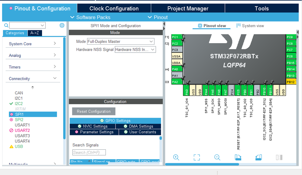

Incorrect configuration for SPI1, SPI2 for Full Duplex Master on discovery board STM32F072RBT6
Sudharshan
Why does the STM32CubeIDE only allow selecting SPI1, SPI2  Full/Half Duplex slave mode for the STM32F072RBT6 Discovery board, while providing incorrect configuration options for Full duplex Master for SPI1, SPI2

Hello @Sudharshan and welcome to the Community :),
Could you please check the "Parameter Settings" and precisely clock parameters-> prescaler  (for baud rate).
Note that, the baud rate must be low or equal to 18 Mbit/s with 4 to 16 programmable bit frames.
Please let me know if the issue is solved.

Hello Kaouthar,
Thank you for your prompt response and providing the information regarding the "Parameter Settings" and clock parameters for the baud rate. I appreciate your assistance.
I have checked the parameters and made the necessary adjustments based on your instructions. The baud rate has been set to a value lower or equal to 18 Mbit/s, and I have ensured that the programmable bit frames are within the range of 4 to 16.
I will now test the system with these new settings to see if the issue is resolved. If I encounter any further difficulties or have any additional questions, I will reach out to you for further support.
