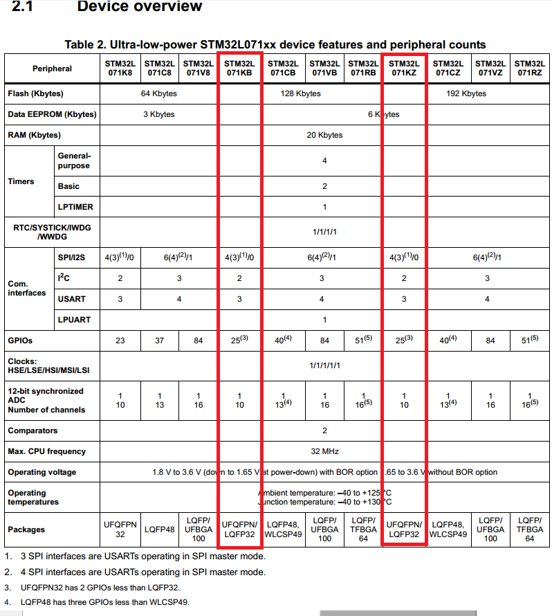

There is an inconsistent information about the numbers of usart in series STM32L071KBTx and STM32L071KZTx
(both LQFP32.)
in the datasheet, it says there are 3 usart:

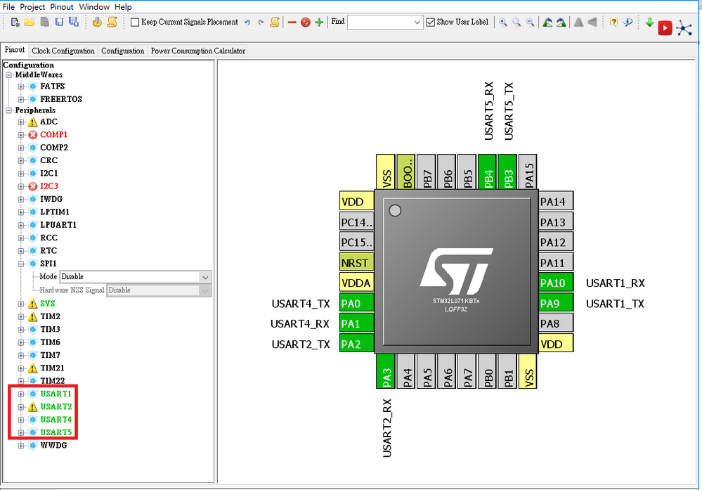

but in the STM32CubeMx, if I choose L071KBTx, I got 4 USART?!
Have I misunderstood something....?
There are totally 3 USART or 4 USART in this package??!!
I would like to know!
Thanks in advanced.

‌,For LQFP32 package, there are 4 USARTs available: you can check it based on pinout table.
However, if you use the UFQFPN32 package, only 3 USARTs can be used.
I agree with you that this has to be precised in the Table 2 of the datasheet.
