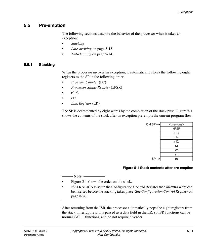

In Cortex M3, what is the order in which the register are pushed into the stack?
Which of the following orders are correct (if any)?
First Order:
      PC
      PSRx
      R3
      R2
      R1
      R0
      R12
      Link Register
Second Order:
      PC
      PSRx
      R0
      R1
      R2
      R3
      R12
      Link Register
Please Guide? Thanks in advance?

Posted on November 21, 2017 at 20:03
Where
R0 = [SP + 0]
R1 = [SP + 4]
etc

Posted on November 21, 2017 at 20:13
See how it indexes hardfault_args here, we pass in SP as parameter ♯ 1, ie R0
