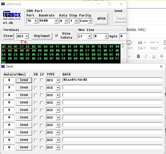

I tested using 485 to USB module then, when I check the terminal, it seems like ok for communicating. actually i got the data what i want
(i attatched jpg file)

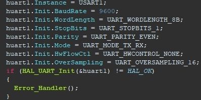

the problem is that using the HAL library and setting 9600 8-E-1 for blue pill, such like attached jpg

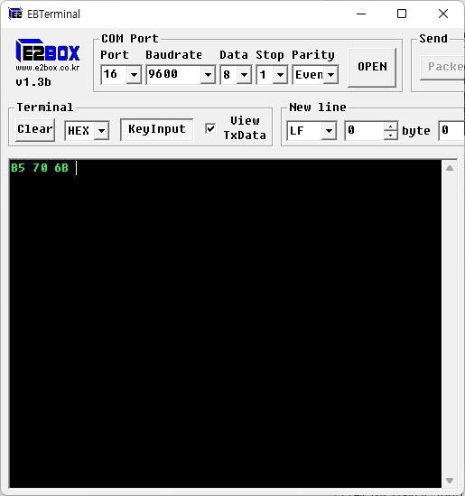

Tx data seems like weird. Result is here
in hal i write
unsigned char tx1_data[6] = {0x02, 0xaa, 0x01, 0xc1, 0x6c, 0x03};
in side while
HAL_GPIO_WritePin(rs485_GPIO_Port, rs485_Pin, GPIO_PIN_SET);
HAL_UART_Transmit(&huart1, tx1_data, 6, 10);
HAL_Delay(5000);
what should i do for this problem?
HAL_UART_Transmit(&huart1, tx1_data, sizeof(tx1_data), 100);//for starters
>>485 communication.
485 communication is half duplex, show us what kind of transceiver are you using, did you tested the transceiver alone?(bluepill is 3v3 , is your transceiver cool with that?)
are you getting consistenly the same wrong results?
2023-02-03 12:00 AM
Delay between activating the transceiver and transfer start?
2023-02-03 12:34 AM
Config in 9 bit mode to accommodate the parity bit.
ST includes it in the data payload, ie 8+1
