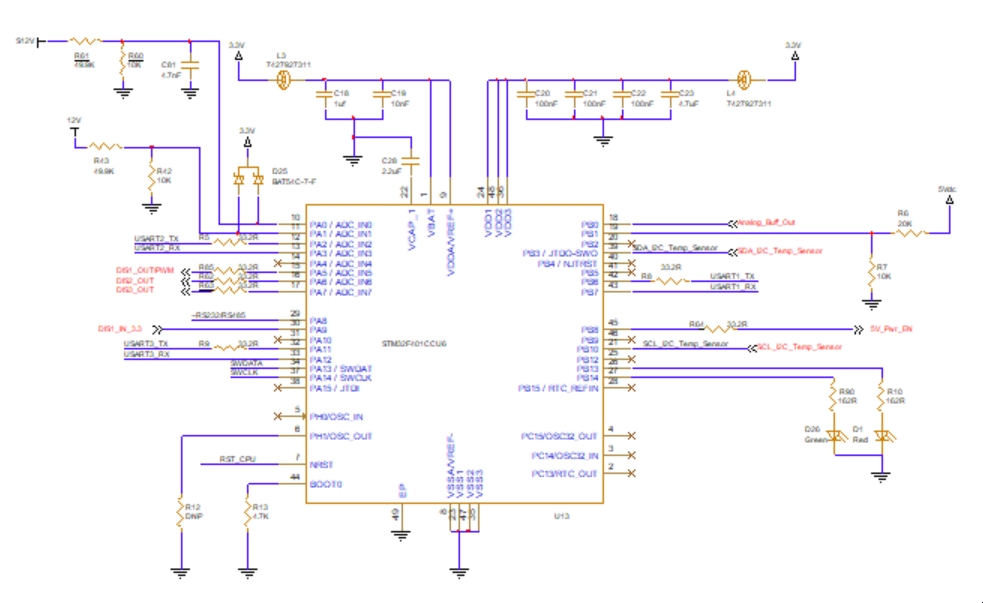

Im Trying to access STM32F401CCU6 in a board i have developed, Using STM32 Cube Programmer with no success.

Hint: maybe someone could help you if you provided some basic information about you problem / schematic, debug connections etc.

Design sounds broken​
Work through the design, fix the errors.​
Check all the power related pins, that it is correctly orientated​.

It seems i have no problem erasing and programing the uC in old versions of STM programmer. Only the new STM CUBE is not reading the uC.
Here are some schematics:

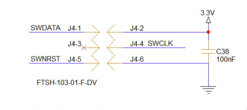

Programming Connector used:
Check firmware and cables
Check connectivity modes, and speeds.
Is NRST connected to the debug pod? Needed for "Connect Under Reset" to work as expected.
ST-LINK/V2 or V3, authentic, or clone?
Avoid using USB Hubs or Docking Stations.
With Micro USB cables make sure to use data or USB 2.0 rated cables, and not charging cables.
