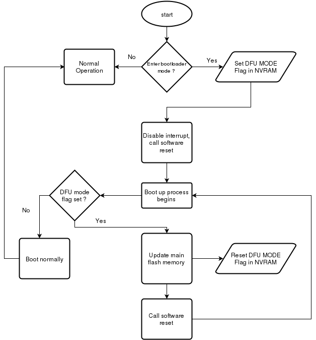

Lately, I've been trying IAP over UART using Ymodem protocol for STM32F072C8 SOC based custom board. The goal is to try IAP with this mode with different upgrade scenarios and later transform these into my actual requirement. I was able to successfully perform IAP using ST provided libraries, IAP driver and template (More information can be found

Please advise on what could be going wrong here and also any pointers on this overall design. Basically I would like to have
- The IAP driver do the upgrade part and application fimrwares should be only triggering IAP process by setting some flag.
- Safely store this flag(0x1) at some address that is beyond code or data region of any of the three images
- Flow should be System startup -> bootloader -> Initiate IAP or jump to fw1 or fw2 (based on flag value)

After spending some time over IAP over GSM network, I'm coming back to this older thread that I had started sometime back.
Environment: SOC: STM32F072C8T6 (64 kB main flash memory) Dev environment: KEIL uVison5 Stack size increased to 4k (Stack_Size EQU 0x00001000 in startup file) The idea is same to have two different application firmware and the IAP driver reside in the main flash memory. A system reboot transfer control to IAP driver, which then jumps to the application firmware and normal operation then begins. A trigger to do firmware upgrade is done in the application firmware, followed by a soft reset. Once again the IAP driver kicks in, finds a flag set in RAM that indicates the firmware upgrade process to initiate, copies the current application firmware into a different memory region (say APP_AREA2), downloads the new application firmware, updates, the application by erasing and programming application area (say APP_AREA1), and then jumps to the application. As suggested to me before, I'm using SRAM to pass few information between the IAP driver and the application firmware and I'm using the memory layout as below:Component

Firmware X here means that any new application firmware is loaded always at 0x08004000. The current application firmware is first copied to a separate area in the flash (starting from 0x0800A000) to keep a backup so that if anything goes bad during the upgrade process, a rollback could be initiated by just copying the older firmware from 0x0800A000 to 0x08004000. This requires a simple copy and rollback routine. However I've few issues: 1: The copy and rollback are not working. 2: I don't think this is the right way to calculate the CRC for the entire firmware, how to do it right ? 3: The IAP flag does get set by the application, however during the boot, IAP driver does not see it as being set (see code below) and gets into the else if branch (iff the application exist at address 0x08004000) instead. However this check for IAP flag works when I go into single stepping by going into the debugger. Why so ? ----------------snip from application firmware---------------------#define APPLICATION1_ADDRESS (uint32_t)0x08004000

‎2016-01-20 10:47 AM
1) Not working how? What messages do you see? What data actually gets written, or not? Add more instrumentation until you can explain what is happening.
2) Probably want to reset it every time rather than make assumptions. Print out values and confirm they correlate with the ones you calculate on the PC side images. 3) Don't know. Is the startup code, or any other variables, stack, or heap conflicting with or clearing the data areas being utilized? Add serial output until you understand the flow of your own code, and the values it is computing, and encountering. It's going to be hard to key-hole debug this without seeing the source, counter-pointed with the output it generates.Up vote any posts that you find helpful, it shows what's working..
‎2016-01-23 7:18 AM
Flashing the application firmware (at address 0x0800 4000) that sets a FLAG in SRAM at 0x2000 00C0 (Since first 48 words starting from 0x2000 0000 is being reserved for vector relocation), and then * powering-off and powering On* so that IAP driver (that sits at address 0x0800 0000) be able to see the flag set, will never work, for the simple reason that SRAM contents are lost during power cycle(I must admit, it was very very stupid of me). So instead of a power cycle, a software reset should work and does work (i.e. flag in SRAM at 0x2000 00C0 is seen by the IAP driver).
This problem is partially fixed, since it seems that my actual application which is about 23 kB in size and also has 4kB stack size (remember, I've set 4kB stack size in IAP driver startup file as well) seem to be messing up the region starting from 0x2000 00C0. As suggested before to me, setting the following in IRAM1 for IAP driver and application firmware *WORKS* only if I remove a big chunk of code, bringing down the application firmware size to about 12 kB. So it seems that the logic is correct, but somewhere in the code, the SRAM is getting messed up. Memory layout in Keil uVision 5: +---------------------------------------------------------------------------+ + Role | IROM1 | IRAM1 + +---------------------------------------------------------------------------+ + | START | SIZE | START | SIZE + +---------------------------------------------------------------------------+ + IAP | 0x0800 0000 | 0x4000 | 0x2000 0100 | 0x3F40 + +---------------------------------------------------------------------------+ + App | 0x0800 4000 | 0x6000 | 0x2000 0100 | 0x3F40 + +---------------------------------------------------------------------------+ My current understanding on the SRAM layout is as below: 0x2000 0000 - 0x2000 4000 : Entire SRAM region of 16kB 0x2000 0000 - 0x2000 00BF : First 48 words reserved for Vector relocation 0x2000 00C0 - 0x2000 00FF : 16 words (64 bytes) reserved for passing parameters between IAP and application So, theoretically, I've about 64 bytes starting from 0x2000 00C0. So, in my application code, I do something like:*(uint32_t *)IAP_FLAG_ADDRESS = IAP_FLAG;

#define FLASH_PAGE_SIZE 0x800 /* 2 Kbytes */
#define APPLICATION2_ADDRESS (uint32_t)0x0800A000
#define APPLICATION_SIZE 0x6000
void
crc_init(
void
CRC_DeInit();
CRC_ResetDR();
uint32_t FLASH_If_Erase(uint32_t StartSector)
uint32_t flashaddress = 0;
flashaddress = StartSector;
while
(flashaddress <= (uint32_t) USER_FLASH_LAST_PAGE_ADDRESS)
if
(FLASH_ErasePage(flashaddress) == FLASH_COMPLETE)
flashaddress += FLASH_PAGE_SIZE;
else
/* Error occurred while page erase */
return
(1);
return
(0);
uint32_t FLASH_If_EraseAppArea(uint32_t StartSector)
FLASH_ClearFlag(FLASH_FLAG_BSY | FLASH_FLAG_EOP | FLASH_FLAG_PGERR | FLASH_FLAG_WRPERR);
while
(flashaddress <= (uint32_t) USER_FLASH_APP_LAST_PAGE_ADDRESS)
if
else
return
(1);
return
(0);
uint32_t CRC_CalcBlockCRC(uint32_t pBuffer[], uint32_t BufferLength)
uint32_t index = 0;
for
(index = 0; index < BufferLength; index++)
CRC->DR = pBuffer[index];
return
(CRC->DR);
int
copy_image(
void
__IO uint32_t dst = APPLICATION2_ADDRESS;
__IO uint32_t src = APPLICATION1_ADDRESS;
uint32_t crc[2];
__IO
int
i;
* Calculate CRC, The size should be in multiples of 32 bit data
* TODO: Replace size value with a macro
crc[0] = CRC_CalcBlockCRC((uint32_t *)APPLICATION1_ADDRESS,(APPLICATION_SIZE/4));
if
(FLASH_If_Erase(APPLICATION2_ADDRESS))
SerialPutString(
Flash erase error
return
ERROR;
/* start copying */
for
(i = 0; i < (APPLICATION_SIZE/4); ++i)
while
(FLASH_ProgramWord(dst, *(uint32_t *)src) != FLASH_COMPLETE) {}
if
((*(uint32_t *)dst) != (*(uint32_t *)src))
SerialPutString(
Error writing image
return
ERROR;
src +=4;
dst +=4;
/* verify the data */
CRC_ResetDR();
crc[1] = CRC_CalcBlockCRC((uint32_t *)(APPLICATION2_ADDRESS), (APPLICATION_SIZE/4));
if
(crc[0] != crc[1])
SerialPutString(
error in backing up firmware
return
ERROR;
sprintf(dbg,
copy_image: CRC[0]: 0x%x \tCRC[1]: 0x%x
, crc[0], crc[1]);
SerialPutString(dbg);
return
SUCCESS;
int
rollback(
void
__IO uint32_t dst = APPLICATION1_ADDRESS;
__IO uint32_t src = APPLICATION2_ADDRESS;
uint32_t crc[2];
__IO
int
i;
crc[0] = CRC_CalcBlockCRC((uint32_t *)APPLICATION2_ADDRESS, (APPLICATION_SIZE/4));
if
(FLASH_If_EraseAppArea(APPLICATION1_ADDRESS))
SerialPutString(
Flash erase error
return
ERROR;
/* start copying */
for
while
if
SerialPutString(
Error writing image
return
ERROR;
src +=4;
dst +=4;
CRC_ResetDR();
crc[1] = CRC_CalcBlockCRC((uint32_t *)(APPLICATION1_ADDRESS), (APPLICATION_SIZE/4));
if
(crc[0] != crc[1])
SerialPutString(
error in rolling back old firmware
sprintf(dbg,
rollback: CRC[0]: 0x%x \tCRC[1]: 0x%x
, crc[0], crc[1]);
return
ERROR;
sprintf(dbg,
, crc[0], crc[1]);
return
SUCCESS;
main(
void
// init relevant clocks and peripherals
crc_init();
copy_image()
rollback();
// crc value mismatch here
while
(1)
// do something
----------------------------snip from serial console logs------------------------------
copy_image: CRC[0]: 0x3c0d7fa CRC[1]: 0x3c0d7fa <--crc calculation after copying the current image at a different region in memory (refer copy_image above)
Updating Firmware............ <--- upgrading firmware
error in rolling back old firmware <--- error
rollback: CRC[0]: 0x8d09986c
CRC[1]: 0x931a25c5 In the rollback routine, the CRC value for app area 2 is0x8d09986c
which is already different than the value reported for app area 2 in copy_image (0x3c0d7fa
