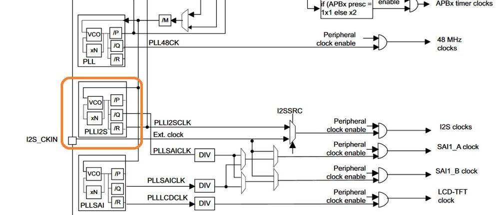

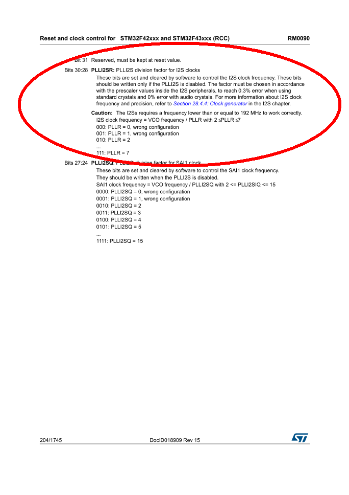

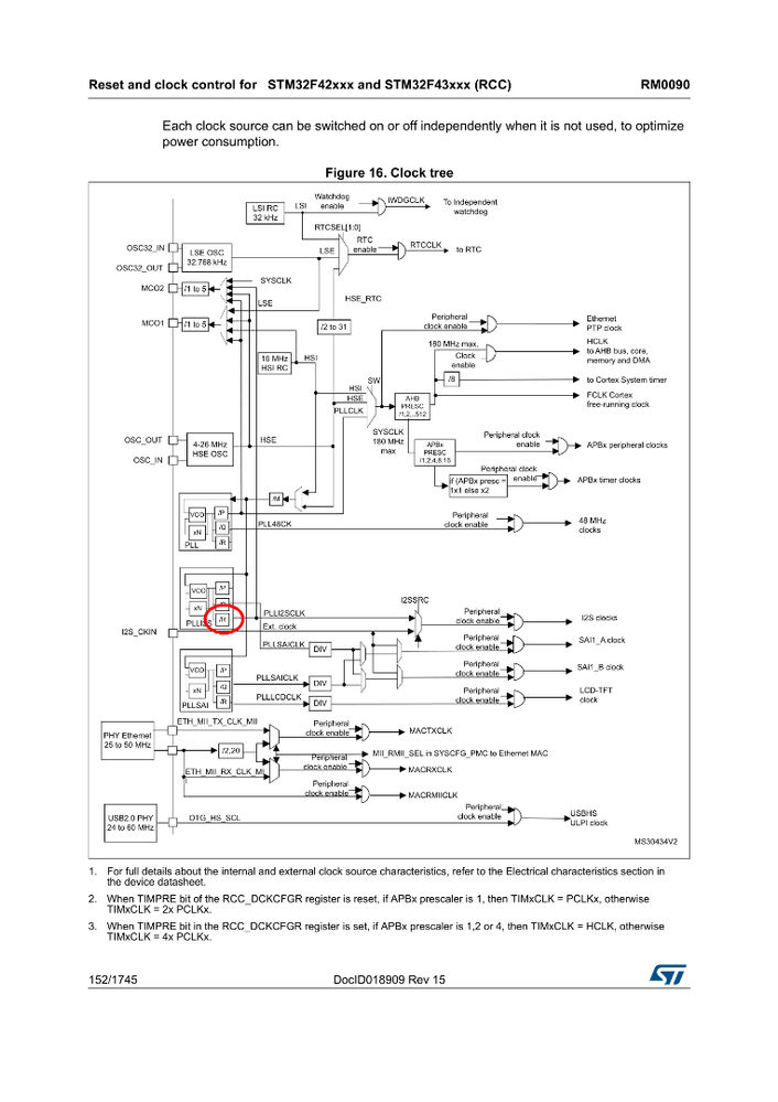

Hi - I'm trying to configure my STM32F429 Discovery board to send digital audio data to a
http://store.digilentinc.com/pmod-i2s-stereo-audio-output/
.  Section 28.4.4 (pg 911) of the
http://www.st.com/content/ccc/resource/technical/document/reference_manual/3d/6d/5a/66/b4/99/40/d4/DM00031020.pdf/files/DM00031020.pdf/jcr:content/translations/en.DM00031020.pdf
says:
To achieve high-quality audio performance, the I2SxCLK clock source can be either the PLLI2S output (through R division factor) or an external clock (mapped to I2S_CKIN pin).
I can't find any other mention (let alone an explanation) of what this 'R division factor' is.  Does anyone know what this means?

Each PLL has three divider taps for the VCO, P, Q and R. On the main one the P one goes to the processor, the Q to USB/SDIO.
Say you run the VCO at 360 MHz, a P setting of 2 gets you to 180 MHz.
Posted on September 25, 2017 at 22:46
Ah, got it, thanks! Makes perfect sense after showing it to me on the clock tree diagram.

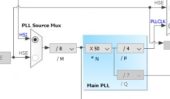

Clive - Thanks for the additional explanation.  One thing, you mention the following:
...you have a VCO (Voltage Controlled Oscillator, basically a very rapid pulse generator, whose frequency is controlled by an input voltage signal), you divide this down, by PLL_N...
I'm not seeing this in in the clock configuration tool below - please see image below.
^It seems like it is not divided down by the PLL_N but instead divided down by the PLL_M and then multiplied by the PLL_N.
Posted on September 28, 2017 at 00:18
That's because the 'xN' hides the nature of the PLL as Clive explained above: it's a VCO and its output frequency is divided down by N and (phase-)compared to the input frequency to PLL (which is the input frequency divided by M).
'Real' frequency multipliers are based on generating then filtering out harmonics. This is an entirely different process, with important consequences on output frequency stability/jitter/noise and vulnerability o being influenced externally eg. through power supply.
This is why the diagram from the RM is superior to that of CubeMX.
