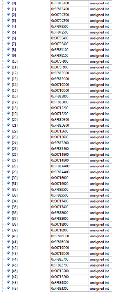

Posted on January 06, 2017 at 09:29
Ok i set the BUFFERSIZE to 100 and disabled the DMA after receceiving 100 Words.
My samplefrequency is 48kHz.
The Signal is a 23,999 kHz Sinus Wave with 0,01 amplitude.
The Master device sends only data on the left channel. Right channel is always zero.
With this setting i should get a positive word, a word filled with zero, negative word, a word filled with zero.
What i get can you see in the picture.
I get positive word. Then same positive word again. Negative word, and the same negative word again.
So the value looks good, only the zeroes are missing. Why is the data from the left channel always written twice ?
Niklas
Posted on January 06, 2017 at 10:05
Ok i found the problem. Wasn't a problem with the Code. I thought the Master send only data on left channel but he sended same data on the right channel. Now everything works correct.
