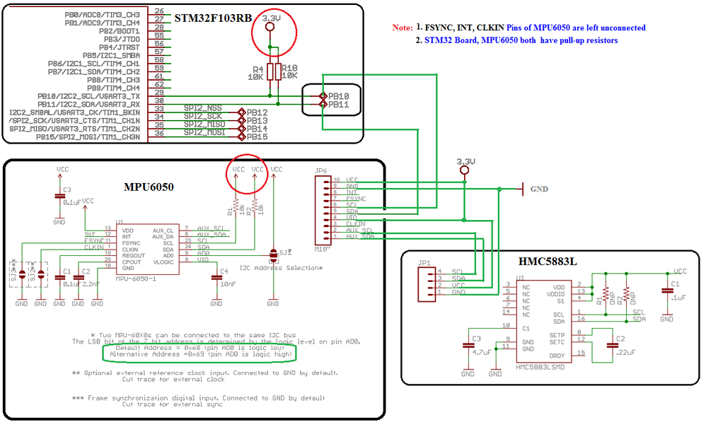

I have STM32-P103 board which uses STM32F103RB micro. I connected an I2C sensor to I2C2 pins. STM32-P103 board, MPU6050 sensor breakout board schematics are below :
0690X000006052GQAQ.png I use only 4 pins of the sensor, SCL, SDA, Vcc, GND.I have the following Initialization code & reading code:

My first post is edited with clear connection diagram. I doubt pull-up resistors. STM32 board as well as MPU6050 sensor board has pull-up resistors. will it be a problem ? Thank you
in your schematics, there are 10k PU on both side. This makes effectively 5K PU. This should not be a problem
harinath
Posted on May 21, 2012 at 08:48
@alokm : I checked the sensor breakout board with Arduino, it works ( note pull ups are 10k). Of course you are right, pull-ups of 5k should not be a problem.
There might be problem in the I2C code or library or something. But I'm sure hardware is not causing the problem.
