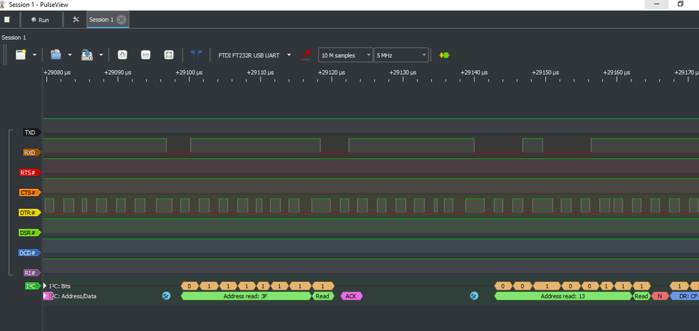

i come up with my question related to I2C communication using stm32F103,
I would like to interface my I2C LCD (slave) with MCU ( master), but i have a problem with the Transmit sequence
i have configured the GPIO's PB6 (SCL) and PB7(SDA) as open drain AF, then intialized the I2C,
I have also followed the transmit sequence as described in the datasheet
- Send start condition
- Check if the start condition is sent , if yes clear the SB flag by reading SR1 register (EV5).
- Transmit the slave adress ( 0x3F for LCD HDD44780 + pcf8574 ).
- Wait for ADDR flag in status register, if there was a match for this
 slave address, clear flag by reading SR1 followed by teading SR2 (
 EV6)
- check if TXE is empty then send the data to data register (EV8_1)
- Check BTF flag
this is the related code below
This is the sda and SCL traces captured with the logic analyzer. RXD--> SDA / DTR--> ClK
My questions are :
1) When i'm using the check condition : while (!(I2C1->SR1 & I2C_SR1_ADDR)) --> check if ADDR matched the slave
or while(!(I2C1->SR1 & I2C_SR1_TXE)) .
the SCL is stretched low permanently and SDA is pulled high, it seems that the master ( MCU) is blocked into these events ( EV6 or EV8_1).
but when i'm using if ((I2C1->SR1 & I2C_SR1_ADDR) ==0) with if, the problem get resolved and i can see the traces.
2) i cannot see the data that i have sent in the traces : as described in the main function I2C_send ( 0x3F, 0x55)
3) The LCD slave adress is 0x3F, but when i disconnect the LCD , i still receive the ACK ( Read and Write) as shown in the picture , is it normal ?
Thank you !
