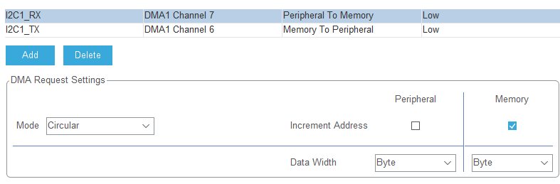

DMA Configuration:
I would like to continuously receive 3 bytes from master, so I use circular mode.

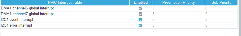

NVIC Configuration:
