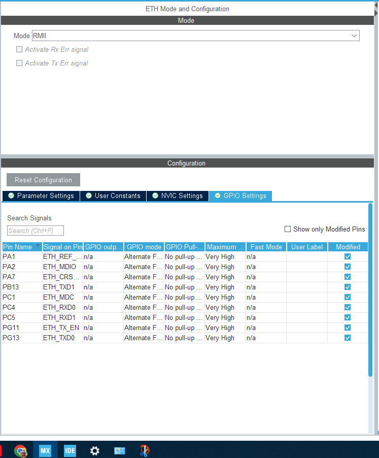

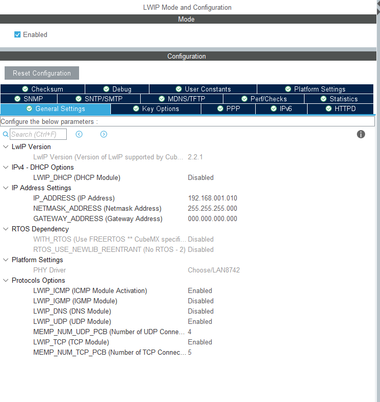

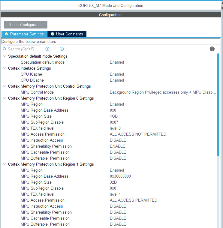

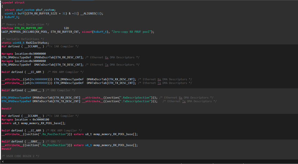

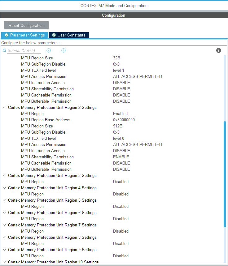

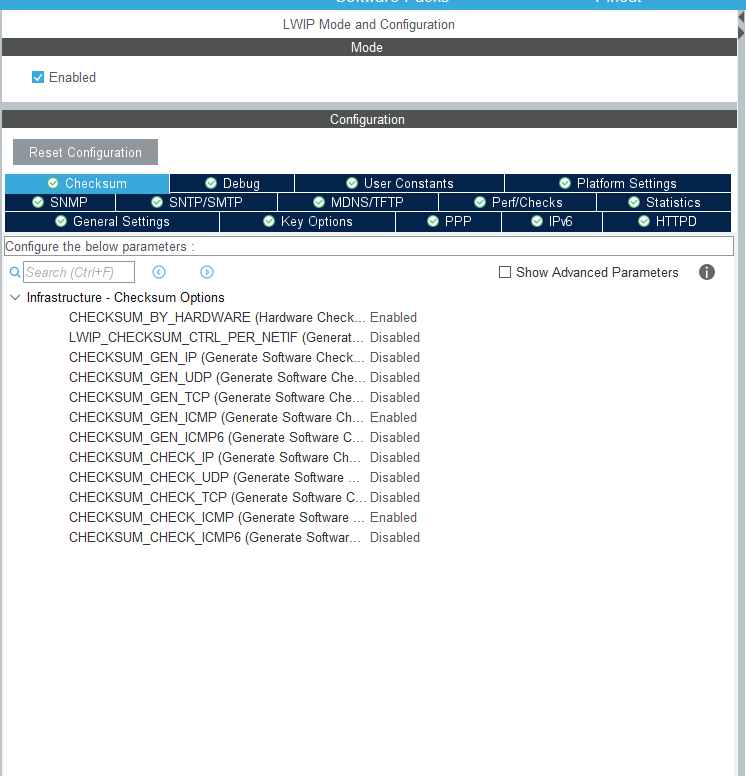

 Hi @Community,

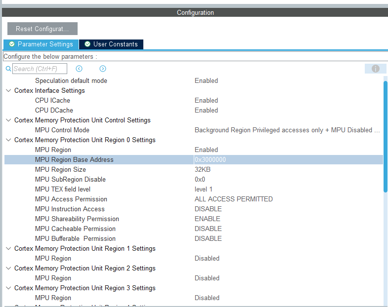

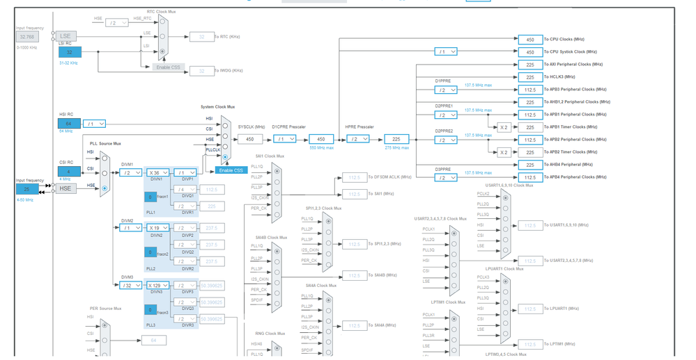

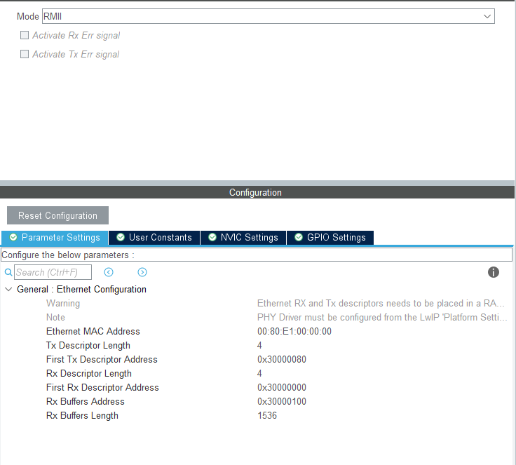

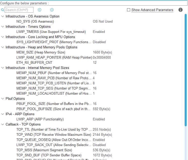

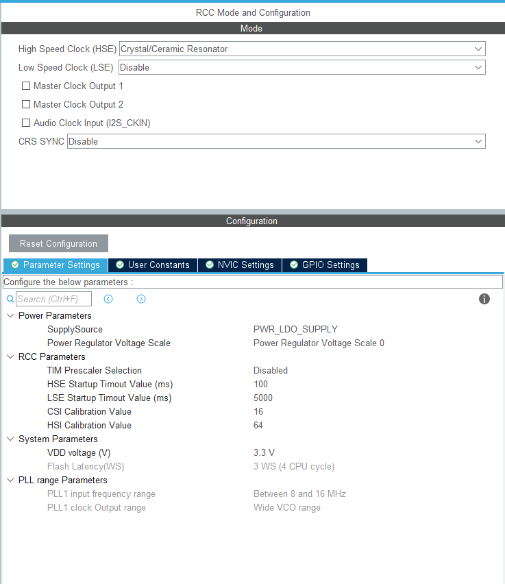

I have previously posted the same issue , that i have been working on the STM32H723ZGT6 - Nucelo board on Ethernet LWIP to acheive TCP/IP without free RTOS, Im still facing the same issue that i cant ping the IP.
I have tried the GITHUB of STM32CUBEH7 -> APPLICATION ->LWIP -> TCPSEREVR ECHO . Its working perfectly , but cant remake or reuse it due to some library issue , im in a middle of a development of a project. so i tried to take the tcp confing in the example code and reuse it , but that also failed
So i tried to remake the all the linker script and searched various Youtube videos , but everything remained in  vain , ill share some screenshots of my configuration , can anybody help me with this , I previously seens several quries that facing the same issue , those who got resolved the issue kindly share your solution and approach with me.
