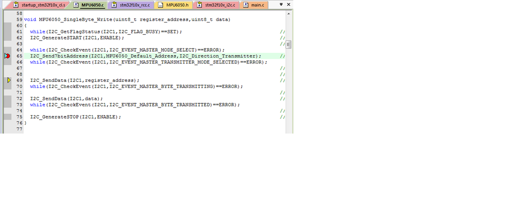

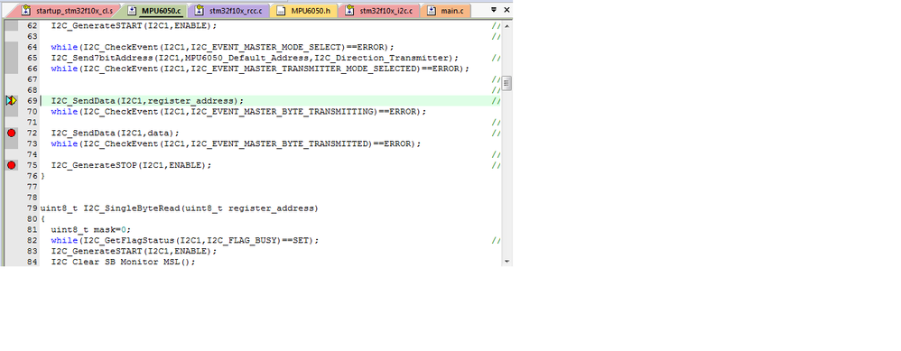

I try 0xD0 . I dont receive nack bit, but this time ADDR bit is not set.Program hangs in
while(I2C_CheckEvent(I2C1,I2C_EVENT_MASTER_TRANSMITTER_MODE_SELECTED)==ERROR); . So I dont understand what is the problem. I dont have any solution. Why ADDR bit is not set ? thanks- Mark as New
‎2013-12-22 3:26 AM
Now I try 0xD0 . but in debug mode I change breakout point location .
here is my screen.I try 0xD0 . I dont receive nack bit, but this time ADDR bit is not set.Program hangs in
