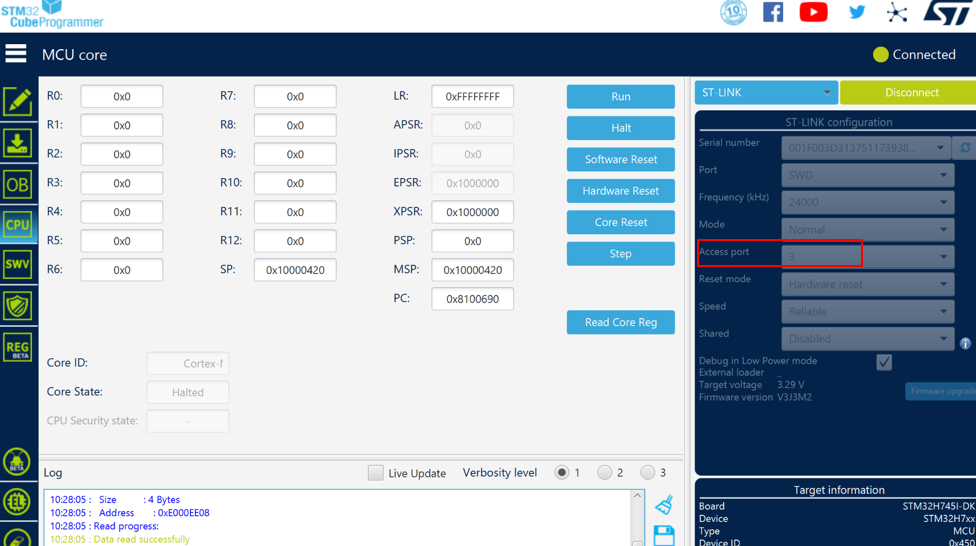

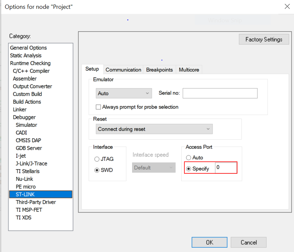

Hello @LVari.1​,
You can do that either on STM32CubeIDE or STM32CubeProgrammer
0693W00000VOaYzQAL.png0693W00000VOacmQAD.pngPlease let me know if there are any issues.
