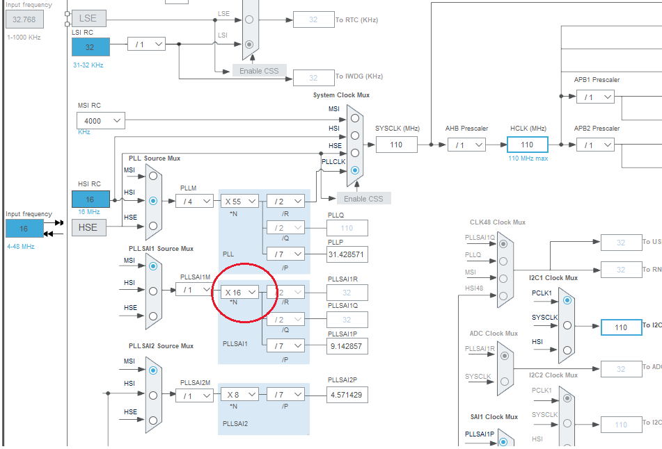

I would like to know how to configure RCC on my evaluation Board STM32L552E-EV.
DYann.1
Senior II
I connect my I2C but when I connect an oscilloscope I have nothing on the clock signal. So probably I misconfigured my clock. Could you give me the information? Thanks in advance.
In this picture below I've a warning, do you know how to remove this warning please ?

It's very strange when I come back to the '.ioc' I have a error and I selected resolve the error automatically. Now I have this configuration :
0693W00000aINGsQAO.pngNormally the value is 8 but now it's 16. So I cant try again.

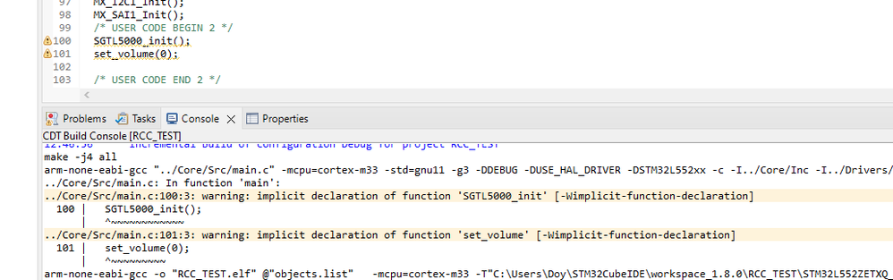

I have a warning :
0693W00000aINNhQAO.pngImplicit declaration what does it means ?
But it's not very important, I can working. Now I have the clock on the SCL (just to have pull-up inside no pull-up).

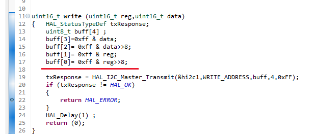

Sorry I have another error :
0693W00000aINBmQAO.pngbuff[0] had to make a shift. But I have always the same error.
Did you add the prototypes?

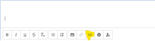

And use the code snippet icon to add code instead of images. Makes it easier to copy code.

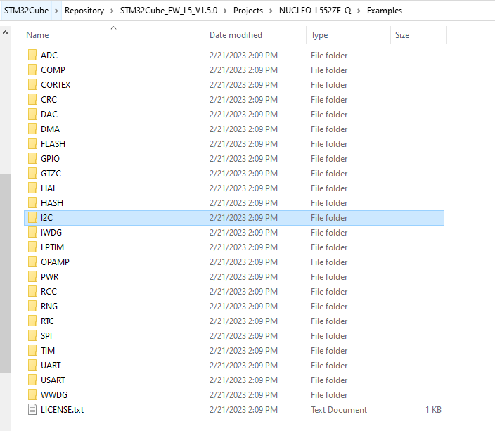

You can use this I2C example. It's the same STM32L5 family and not tied to a specific development board.
