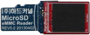

eMMC memory connects like an SD card would, the primary communications pins are the same. The STM32F769I-EVAL board supports two microSD sockets.
One can evaluate eMMC using ODROID adapters and modules. There is a microSD form-factor adapter.
https://www.hardkernel.com/main/products/prdt_info.php?g_code=G135415955758
Driver code needs to be modified to recognize and use eMMC based memory. I can consult on that if you need assistance.

Posted on June 18, 2018 at 13:56
That's great to know. The ODROID module you mentioned is cool. I shall use this to test my program on the kit. But, finally I would like to make a PCB with STM32F769I interfaced to eMMC. Can I get any reference design for this purpose?

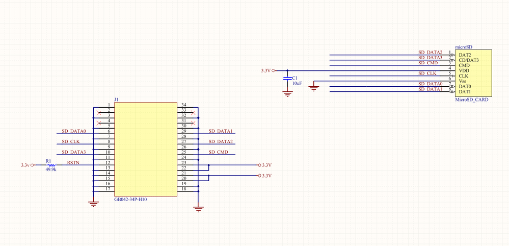

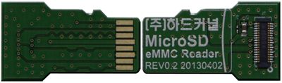

Posted on June 18, 2018 at 14:15
The adapter for uSD looks like this
The module itself is very simple, also see attached PDF (open thread in thread view rather than inbox view to see attachment)
Integration into a design should be a trivial exercise.
