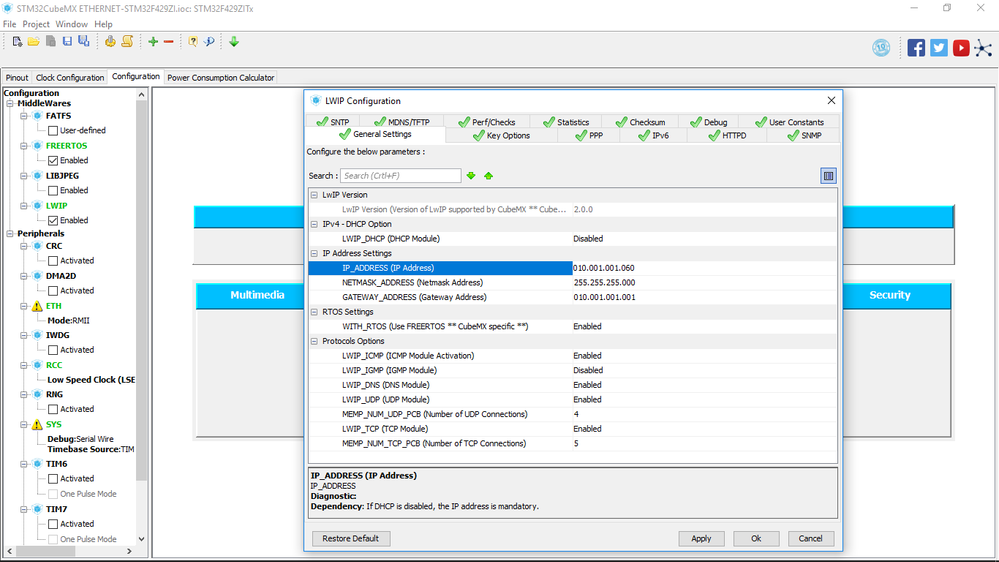

hello when i connect two stm32 one ip 1.1.88 port 88 the other one is 1.1.70 port 70 to a with switch device using udp to a remote pc ethernet ip 1.1.89 , if one send data the other stm cannot send ???? separatly they can work very good
on the same time they cannot work ??
do i need a special switch for that ??? which one

hi i declare this way
ip_addr_t local_ip;
ip_addr_t remote_ip;
then i fix it :
for local by cubemx if static
and for remote this way in my application :
IP4_ADDR(&remote_ip,10, 1, 1,89);
