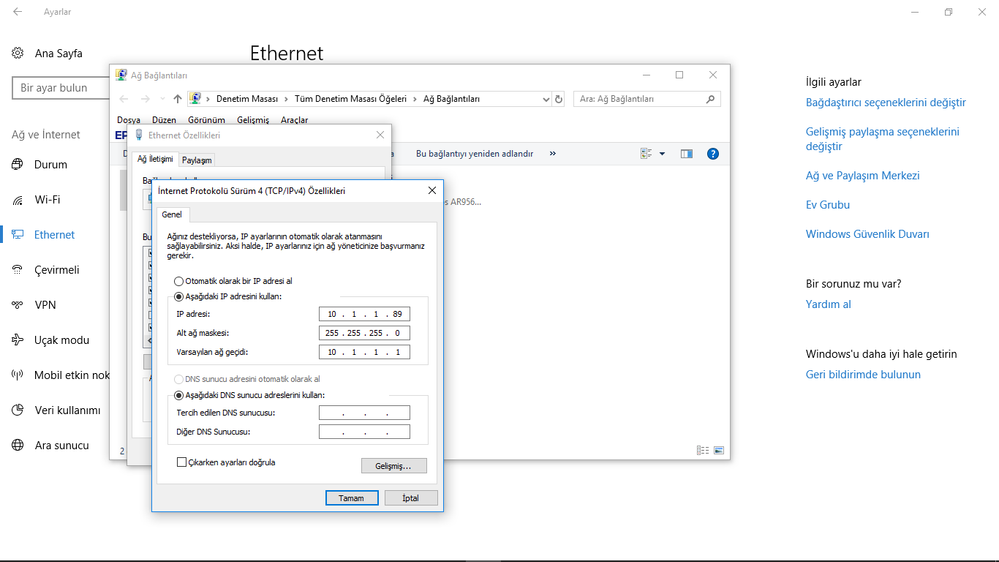

remote ip 10.1.1.89--->is my pc you can fix it if you want static by parameters .

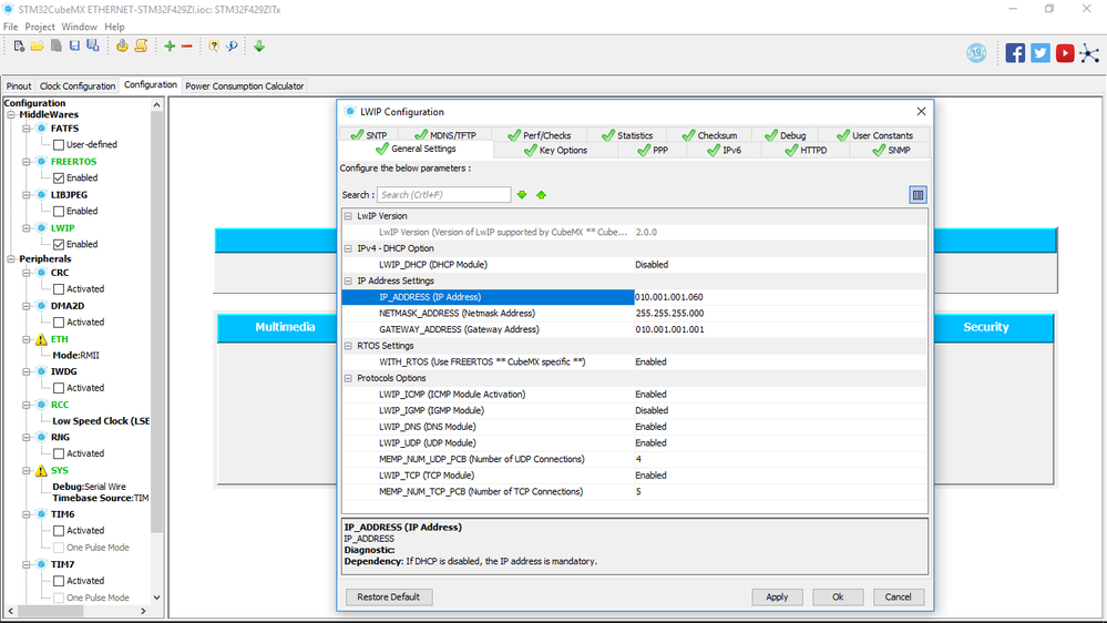

you need to make gate way 10.1.1.1 and mask 255.255.255.0
on both pc and device this is my pc config it is my host for my application
you can use this code for udp , in cube you fix the ip as static 10.1.1.60 of our stm
