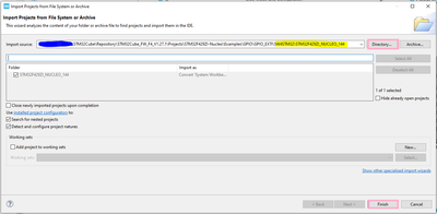

Hello @Koseo.1 ,
Concerning the System Workbench toolchain, called SW4STM32, is no more supported for all new series. For that I recommend you to use STM32CubeIDE.
In this case, and to open your project, I advise you to follow these steps:
1- Open STM32CubeIDE
2-Click File-->open projects from file system or Archive
3-Import source as shown in the below figure
4-Build the project
I think this user manual can help you Migration guide from System Workbench to STM32CubeIDE - User manual.

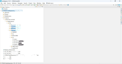

Hello.
I checked what you sent me.
As you said, we succeeded in putting the project on Project Explorer.
But I haven't been able to build since.
And I attached the picture below, but the project build (hammer picture) you mentioned is not working.

I was surprised because the reply was fast.
But there is a reason why I added the STM32CubeExpansion_xxxx folder itself as shown in the picture.
First of all, it was because I added the STM32CubeExpansion_xxxx folder itself as shown in the picture I attached in the enclosed user guide.
And secondly, in the picture I posted, the user guide said that I need to use two versions of STL_Lib_product_x1.a and STL_Lib_product_x2.a in the STM32CubeExpansion_xxxxx folder -> Middlewares -> STM32_Safety->Lib folder.
I think the STM32CubeExpansion_xxxxx folder itself should go up, but I was wondering if I was wrong.
