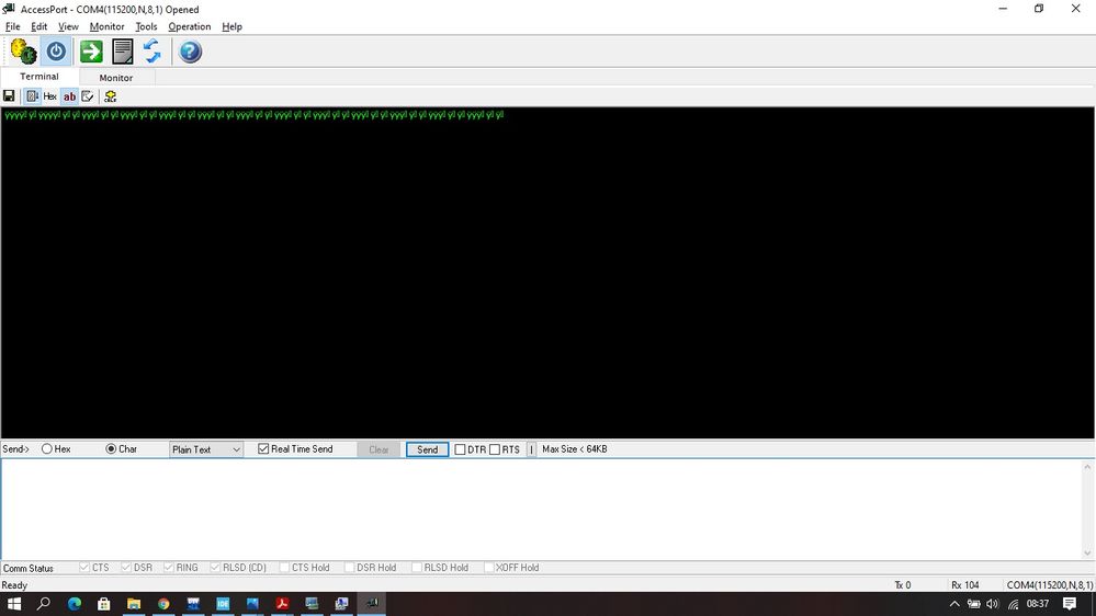

I'm using STM32F103(blue pill). Usart1 connection with pl2303. My codes right here
uint8_t data;
  /* USER CODE END 2 */
  /* Infinite loop */
  /* USER CODE BEGIN WHILE */
  while (1)
	HAL_Delay(1000);
	  if(HAL_USART_Receive(&husart1, &data, sizeof(data), 0) != HAL_TIMEOUT)
	   HAL_USART_Transmit(&husart1, &data, sizeof(data), 0);
    /* USER CODE END WHILE */
    /* USER CODE BEGIN 3 */
Simple echo program. But my port reader program(AccessPort) always take a meaningless
data when I launch board. Accesport screenshot right here.
0693W000005BRO7QAO.jpg What is the problem?

The problem is probably the timing between the MCU and the terminal program doesn't match.
GRico.1
That's problem right because my usb - ttl converter doesn't have any clock pin. But How can I read usart output from my pc.
