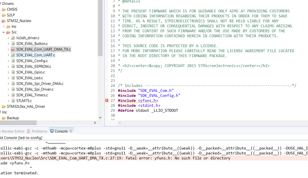

I am trying to run the S2-lp SDK example project on truestudio but i am running in so many errors? and missing files?
MTomo
0690X000006CAEOQA4.pngI am trying to run the S2-lp SDK example project on truestudio but I am running in so many errors. one of them is that the yfuns.h file is not even the directories.
2 REPLIES 2
AvaTar
Lead
I don't know this SDK, but it seen your project is not properly set up.
Have you tried to locate this missing files, and add the appropriate path(es) to te includes ?
Andrew Neil
Do you mean this: https://www.st.com/en/embedded-software/stsw-s2lp-dk.html ?
As @Community member​  suggests, the commonest reason for not finding header files (when they do actually exist) is that the Include Paths are not correctly set.
