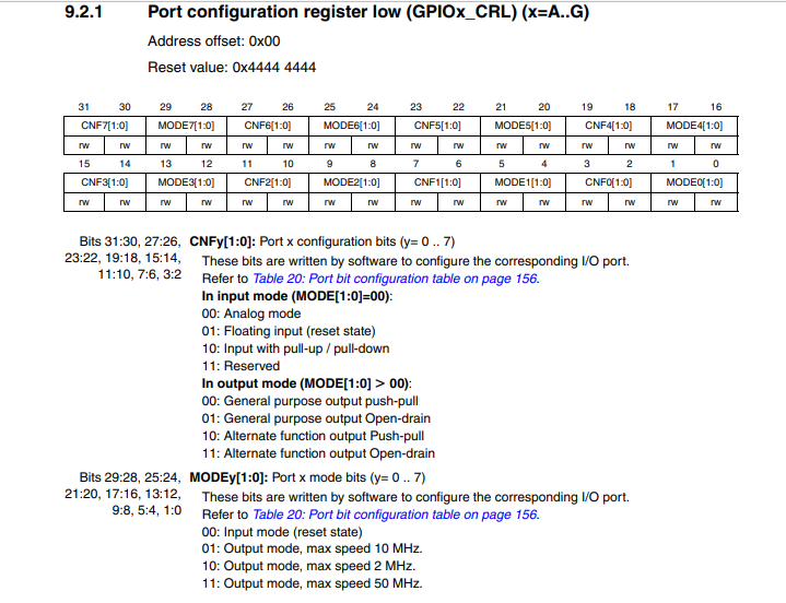

‎2022-04-09 10:05 AM
I don't use the 'F1, but for Alternate mode Push-pull Output, you must set the CNF field of GPIOx_CRL to 0b10 and the MODE field to nonzero.
Note, that the CNF field is by default set to 0b01, so by ORing 0b10 to is you get 0b11, which would be Alternate mode Open-drain.

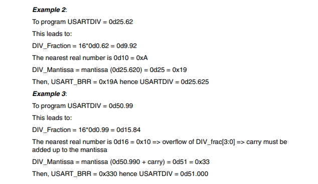

‎2022-04-09 11:37 AM
You can't change the BRR on the UART after you've enabled it.

‎2022-04-09 01:24 PM
Clive, @Community member​
> USART2->BRR = (36000000 / (16 * 9600));
No, the comment is lying.
‎2022-04-09 02:55 PM
USART2->BRR = (36000000 / 9600); // compiler folds the math for constants

There are errors in almost every line of your code.
- IN F1 series, peripheral inputs should be set as inputs, NOT as AF, so only PA2 - TXD should be set as AF
- In general, you cannot use |= for setting CRL register. Use simple assignment, or sequence &=, |= with proper bit masks.
- Two instructions for setting up the UART should be (in this order):
USART2->BRR = (APB1_CLK + UART_BAUDRATE / 2) / UART_BAUDRATE;
USART2->CR1 = USART_CR1_RE | USART_CR1_TE | USART_CR1_UE;
To write data, use USART2->DR = ch; DO NOT use |=.
‎2022-04-12 04:36 AM
I have changed the code as per your comment but I am not able to transmit the data. I have also altered the CRL and now it reads 'B' - 1011 for the pin A2 and A3. Can you please tell me any changes to be done?
‎2022-04-12 04:49 AM
Thank you for your response , I have changes the bit as per your suggestion but i still see no communication, I have changed the data as
GPIOA->CRL |= GPIO_CRL_MODE2_Msk; /*Eanble Max frequency of 50 MHz(11)*/
GPIOA->CRL^= (GPIO_CRL_CNF2);/*Enable Alternate function for Pin A2 (03<<10U) */

I have obtained the value 0xEA6 as per the example shown in the reference manual. PFA
