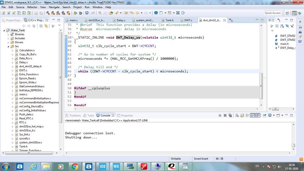

I am Going To Generate 10us delay for ultrasonic sensor in STM32L152RET ,HAL_Delay() is Create Delay Upto ms,How It Can Generate?

Use a free running TIM at 1 MHz or faster, and delta the count, or use the DWT CYCCNT register, it is 32-bit and counts processor cycles, so good to a few 10's of nanoseconds in most cases.
Definitely don't use interrupts.

0690X00000Bw97GQAR.pngthis is our program and it is getting stuck into the dummy while loop...why dose this happen.as we have observed,stm32l152ret always gets stuck in dummy loops..why is this so?

If concerned use TIM2 or TIM5, 32-bit on most of the cores worth using. For short duration stuff the 16-bit would also be serviceable.
>>why is this so?
Why must one guess? Debug the code, have a HardFault_Handler() output actionable data, avoid unbounded while() loops. Have ErrorHandler() report a file and a line number
For the DWT make sure it is initialized.
If the debugger drops the connection look for WFI or low power modes turning OFF the pins and debug interface.
