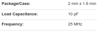

I notice that the cristal FA-128 25.000MF20X-K0 from Epson should have 20pF CL.
This means approx. CL1 = 33pF & CL2 =33pF if I add few pF for PCB track.
I'm a bit worried why the capacitance on this cristal is that high?
Can you see any potential problem?
Many other crystals like Murata and so on have CL=6pF-10pF
AScha.3
from mouser ...: FA-128 25.000MF20X-K0
or take other one:
https://www.mouser.de/ProductDetail/ECS/ECS-250-10-37B2-CTN-TR?qs=QNEnbhJQKvYEizOb3GqO%252BA%3D%3D
