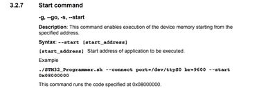

I'm not an expert of CLI programming. But I think you should add this command:
Also, you may find help reading this UM2237 specially chapter 3 and the part 3.2.22.
Best regards.

Hello, thanks for your response.
Because I'm clearing nBoot0 and nSWBOOT0 bytes until I set them again my firmware does not start. If I call start command without setting those bytes device leaves bootloader mode but my firmware does not start.
If I set nBoot0 and nSWBOOT0 bytes my firmware immediately starts. (But ST's CLI app tries to reconnect and it timeout.)
The problem is that this doesn't always work. For example it fails 1 out of 10 times. So, I suspect that I'm doing something wrong. Is there a more consistent way to do this?
