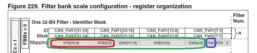

I tried to configure CAN ID filter to only allow ID = xxEAECxx to go through CAN2
static void CAN_Filter(void)
CAN_FilterConfTypeDef sFilterConfig;
sFilterConfig.FilterNumber = 14; //0-13: CAN1, 14-27:CAN2
 sFilterConfig.FilterMode = CAN_FILTERMODE_IDMASK;
 sFilterConfig.FilterScale = CAN_FILTERSCALE_32BIT;
sFilterConfig.FilterIdHigh = 0x00EA;
 sFilterConfig.FilterIdLow = 0xEC00;
 sFilterConfig.FilterMaskIdHigh = 0x00FF;
sFilterConfig.FilterMaskIdLow = 0xFF00;
 sFilterConfig.FilterFIFOAssignment = 0;
 sFilterConfig.FilterActivation = ENABLE;
 sFilterConfig.BankNumber = 0;
 if(HAL_CAN_ConfigFilter(&hcan2, &sFilterConfig) != HAL_OK)
  /* Filter configuration Error */
  Error_Handler();

Pretty sure that's not the right bit position for the Source Address, nor PDU Specific/Format, in the J1939 sense. I'd also filter on the IDE designation.

Sorry, that's my mistake, I need filter PDU and destination Address (not source Address), because my device only care the message from Master contains with PDU and destination address of my device, for example: any message on the Canbus line with destination address not equal my device (0xEC) will be filtered out. my device does not communicate with other slave device, only communicated with Master controller.
uint32 extid = 0x0EAEC00; // 00=Source ID EXTID[7..0], EC=PDU Specifc EXTID[15..8], EA=PDU Format EXID[23..16]
uint32 mask = 0x0FFFF00; // Ignore EXTID[7..0]/EXID[28..24], Pass EXTID[23..8]
extid = (extid << 3) | 4; // EXT
mask = (mask << 3) | 4; // IDE=1
sFilterConfig.FilterIdHigh = (extid >> 16) & 0xFFFF;
sFilterConfig.FilterIdLow = (extid >> 0) & 0xFFFF;
sFilterConfig.FilterMaskIdHigh = (mask >> 16) & 0xFFFF;
sFilterConfig.FilterMaskIdLow = (mask >> 0) & 0xFFFF;
