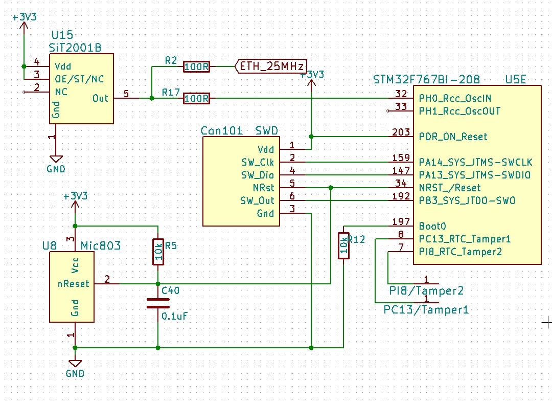

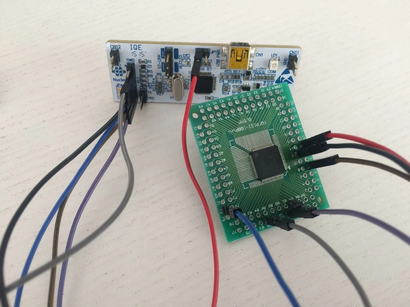

Hi, I have a ST_Link Programmer that was cut off from STM32F411RE Nucleo 64 Board (zero ohms resistors SB12, 13, 14, and 15 have been also removed). I have been use it to program a stand alone STM32F411RE chip with no problem.
Currently I am doing a project that is using STM32F303RE Nucleo 64 Board and I have a custom made PCB with STM32F303RE chip on it. I tried to use the same ST_Link Programmer to program the chip by connect the 6 pins from the programmer to the chips, but it does not work. The pins are connected the same as how I connect my programmer to the nucleo board.

With the connection above, I can program my STM32F411RE chip with external ST-Link programmer that I cut off before. Everything works fine.
And then I connected the same programmer to my STM32F303RE Chip with exactly the same connections.
This time, when I connect the program to my computer, same storage disk (NODE_F303RE (D:)) has jumped out, however, in stead of usual two files ( DETAILS.TXT and MBED.HTM), there is one additional file called FAIL.TXT, and when I opened it out, it shows: The interface firmware FAILED to reset/halt the target MCU.
I am not sure how to fixed this, if anyone can help, that would be appreciated.
PS. I have also tried to connect the external programmer to a STM32F303RE Nucleo board with same connection as above, and I was able to program the board. Datasheets show that both STM32F411RE and STM32F303RE are similar and has almost the same pins. One possible reason that I can think of is that the STM32F303RE chip that I bought is faulty.

    I checked my board's schematic, your connections are good
    I use the 64 pin too,I have used a 303 and an 091 in this board, without issue.
    do you have another target board ?
    maybe you should check the processor under the microscope and reflow the pins. make sure you use flux, or don't attempt it.
    otherwise pull it off, clean up and replace it.
    what did you do with pin 28  PB2/ Boot1 ?
    this may be giving you trouble too...

    Going to need critically at the custom board. If you exposed USART1 PA9/PA10 you should try the System Loader (BOOT0=High, Reset) by sending the 0x7F pattern at 9600 8E1, and checking for the 0x7F response byte.
    Check VDD/VDDA
    Check NRST logic level
    Check part orientation and pin numbering in design

    I tried with the programmer that I cut off from Nucleo STM32F303RE Board. it did not give me the FAIL.TXT, however, when I program the chip with Keil, it said that: No Target has been found. I am not sure what is going on tho.
    Programmer from STM32F411RE Nucleo board with STM32F411RE: No FAIL.TXT, Programmable
    Programmer from STM32F411RE Nucleo Board with STM32F303RE: FAIL.TXT, Not Programmable
    Programmer from STM32F411RE Nucleo Board with nothing: FAIL.TXT
    Programmer from STM32F303RE Nucleo Board with STM32F411RE: No FAIL.TXT, Programmable
    Programmer from STM32F303RE Nucleo Board with STM32F303RE: No FAIL.TXT, Not Programmable
    Programmer from STM32F303RE Nucleo Board with nothing: No FAIL.TXT
    Any Idea will be helpful. Thank you.

    It looks like you have 2x 303RE boards, maybe one of them is faulty.
    Zhiyong Wu
    January 29, 2018
    Posted on January 29, 2018 at 07:27
    I have one programmer cut off from 411RE Board, one programmer cut off from 303RE Board, one 411RE stand alone chip, one 303RE stand alone chip. and I am trying to use the programmer to program the chip, with 411RE chip, it is working, but not the 303RE chip
