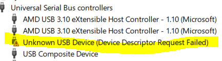

Hello Everyone, I have implemented FS USB on STM32F303RE nucle board. But I detach the programmer and want to use the STM as a stand lone,Then the usb is not working, I

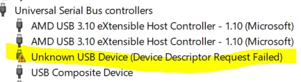

This my error message
This is my error:

As a quick check/fix, perhaps add a 250ms delay at startup before initialization of USB.

Patukes
PatukesAuthor
December 13, 2021
Thank you everyone one for the answers you provided. The major problem was that the micro-controller started with the internal RC oscillator(clock) ; this can't work with USB as USB requires a more stable clock. So I used an external clock.
