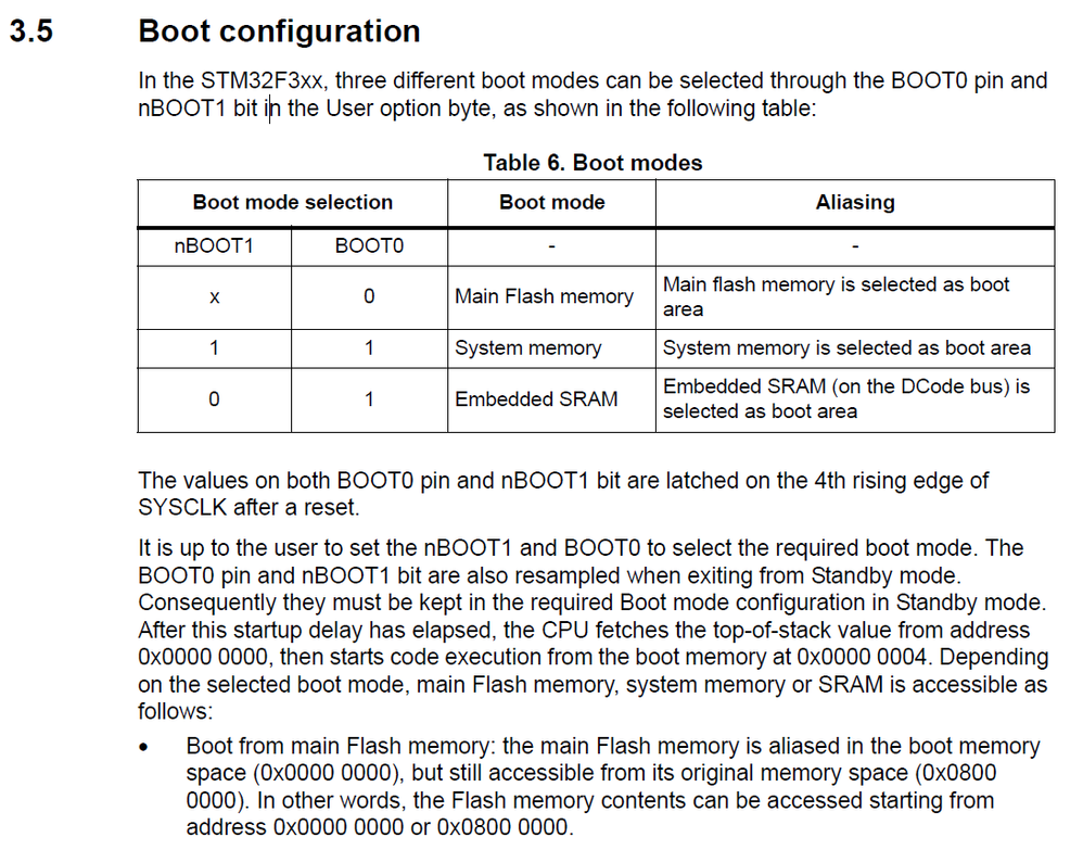

    T J
    Senior III
    Jan 17, 2018 7:31 AM UTC
    Posted on January 17, 2018 at 07:31
