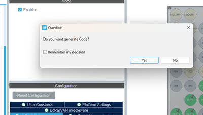

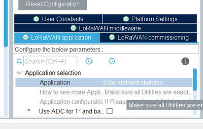

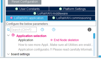

Next, I opened the MX component and made some changes to the microcontroller configuration. I double-clicked on the LoRaWAN_End_Node.ico, and made changes to the LORAWAN settings.
Upon closing the MX component, it asked me to generate code. I answered yes.

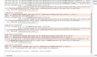

I tried to build the project, and I got several unexpected build errors.
I didn't do any manual changes to the code.

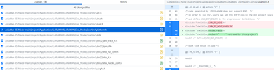

‎2023-12-12 7:54 AM
WTF?
After saving code from MX I see:
