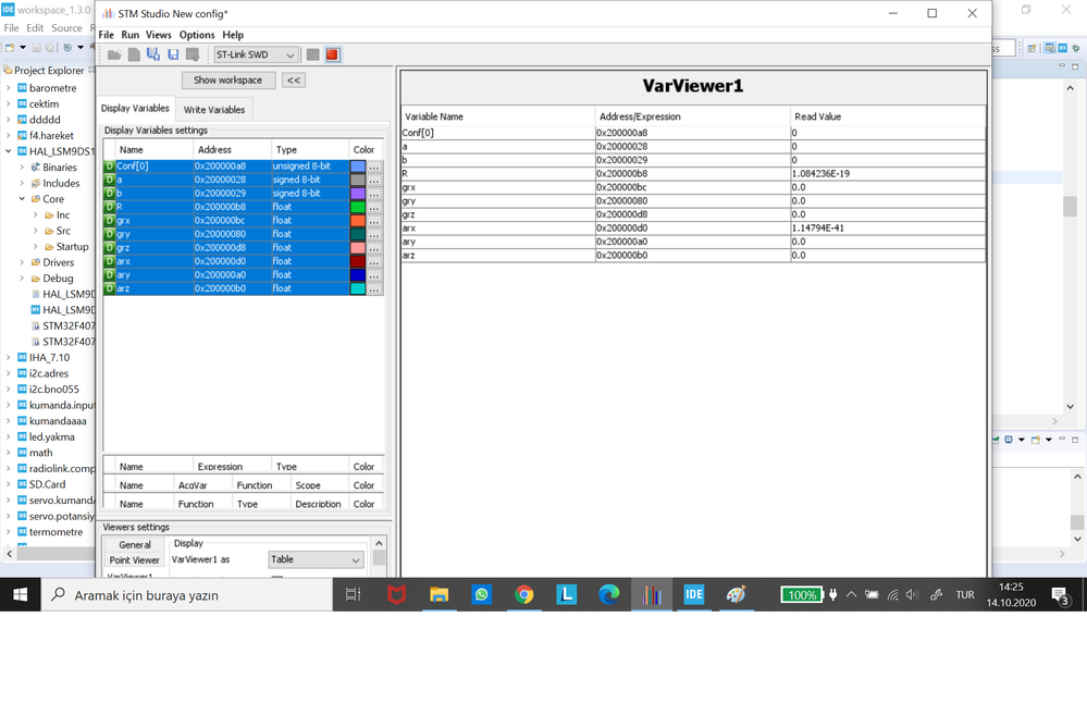

Hi everyone! I am using STM32F4 and IMU to read gyro and accelerometer, and than calculate IMU's euler angles. I can get data from IMU it is OK but when I try to add something from math.h program stops working but it also don't gives error or warninng -I can't even read acceleration and gyro data in STM Studio-. I need to use sqrtf() and acosf() functions. I think I am using math.h library in wrong way. Here is my codes math.h related parts:

 R=arx*arx+ary*ary+arz*arz;
//if I make bottom part comment program works as it will but if I don't it don't :(
R=sqrtf(R);
 HAL_Delay(30);
 aanx= acosf(arx/R);
 aany= acosf(ary/R);
 aanz= acosf(arz/R);
 HAL_Delay(30);

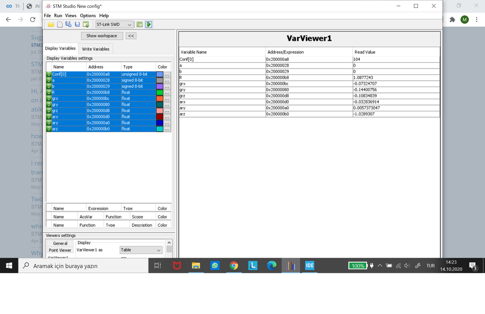

Here is the results with math.h and without math.h:
MDoğr.1
I changed pins pb7 pb6 to pb9 pb8 and it started to work welll

MDoğr.1
