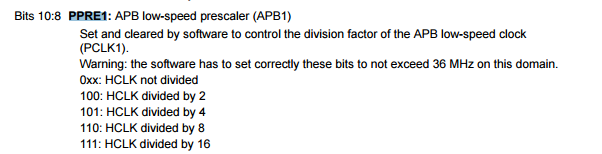

How to use APB1 prescaler in stm32F100
‎2017-04-06 6:27 AM
Which register to be used?
‎2017-04-06 6:46 AM
You should refer to the reference manual related to your device and you find all details about APBx prescaler and register.

okay. I do have the related reference manual but cant understand which particular register to use. Nothing is mentioned.
‎2017-04-06 10:15 AM
You should refer to the ''Reset and clock control (RCC)'' inside the RM0041, exactly the Figure 8. STM32F100xx clock tree (low and medium-density devices) to have idea about clock tree and in the ''Clock configuration register (RCC_CFGR)''
You can use STM32CubeMx which is a graphical interface performs easy configuration and clock tree. (Please refer to ''Clock tree configuration view'' section on the UM1718 user manual).
Hope this help you.
