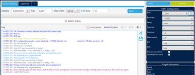

I am trying to connect the bootloader by UART in stm32cubeProg, but it failed... The steps are as follows:
    1. pull boot0 high;
    2. click the connect button in stm32cubeProg;
    3. reset the MCU, then some error message in the attachment;
I can enter the UART bootloader by serial assistant as following steps:
    1. open the serial assistant and keep sending 0x7F;
    2. pull boot0 high;
    3. reset the MCU;
    4. the serial assistant can receive 0x79 0x1F 0x1F....
