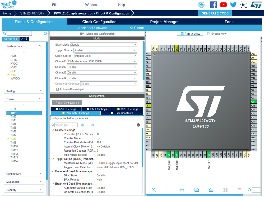

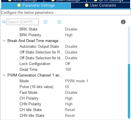

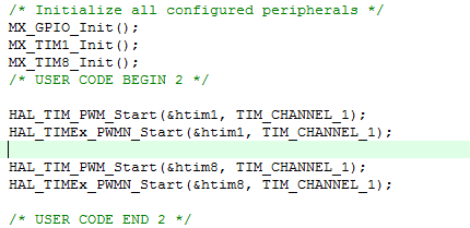

I use STM32F4 discovery (STM32F407VG). I've to pilot 4 command that are complementary 2 to 2, for 2 synchronous BOOST.
So i need 4 signals, and i use 2 timers in PWM mode to generate 4 signals (Tim 1 : CH1 and CH1N and Tim 8 : CH1 and CH1N).
I succeeded this step, now I want to phase shift the timers 1 and 8 of pi but i can't put them on a same clock...
I hope u understand what i mean ..
‎2019-05-07 12:42 AM
I show you the code and settings of Cube MX. If you have an idea...
