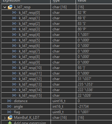

I have a sensor that can communicate via UART, I send a command and the sensor answers me with a hexadecimal frame.
I can have distance, angle, velocity values.
I know how to store the frame in a buffer but I don't know how to store it in hexa to keep the form 0xFF6F and identify if the value is negative or positive.
There is the code i have made to identifier and read value inside the buffer

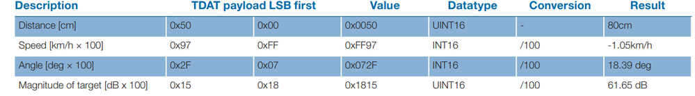

you say something about hex but you send and rec over UART binary data.
In payload table you have info for types and conversions
simply use
int16_t angle;  //stored *100 value dont use float if not required
uint16_t distance;
angle = *((int16_t *)&k_ld7_resp[12]);
distance = *((uint16_t *)&k_ld7_resp[8]);

I tried with type int16 for the angle, now I have the negative sign but the value is completely wrong.
void sensor_data(void){
	if (flag == 1) {
		HAL_UART_Transmit(&huart1, TDAT, sizeof(TDAT), 13);
		HAL_Delay(100);
		flag = 0;
	distance = k_ld7_resp[8] + k_ld7_resp[9]*0x100;
	angle = (*(int16_t*)&k_ld7_resp[12] + (*(int16_t*)&k_ld7_resp[13])*0x100) / 100;
Your conversion is bad dont need handle [13]*256 use my syntax and if you need angle in debree add /100. You dont show how type is angle global in your code.
Thanks, it finally works and returns the right values
