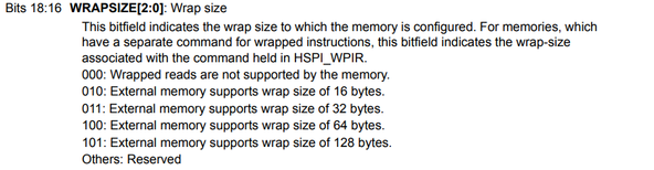

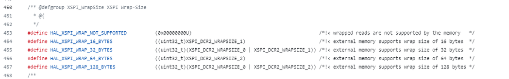

November 21, 2023
Hi @RMand ,
About the question 4: The HSPI supports an hybrid wrap and the wrap size is supported by configured WRAPSIZE in HSPI_DCR2:
This configuration is described in the stm32u5xx_hal_xspi.h Hal drivers:
Thanks and best regards,
