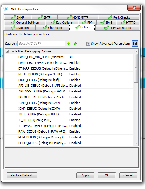

i already have done the setup for the lwip stack on the STM3210C-Eval board. I can already send via TCP/UDP and also RS232 to the uC (PC-->uC) and get also a echo back (uC-->PC). The debug output of the lwip-stack is already configured via cubemx, too. But i have absolutly no idea, how to configure the lwip-stack (via lwipopts.h or something else) that i can see the debug output of the lwip on RS232. Can anybody give a hint ?

Hi Jan, thank you for your fast and very good response ! I enabled the debuggin via cubemx and thought, that LWIP_DEBUG is already defined. I didnt have a look on it and that was the cause of the problem. Now i can debug . Thank you

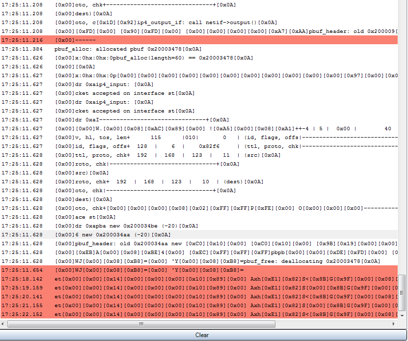

You can change the settings of WHAT the debug output should show. Now im fighting with my debug output . Do you
have another hint, how to format the lwip debug output, so that i can send it via uart ? Because the output messages are formated to be handled by printf.... i tried snprintf to save the string into an array, but there is an error with ''too few arguments''.

Couldn't in CubeMX a tickbox needed to enable the debug globally be hidden in some other place?

I havent found a radiobutton yet. I give your hint a try and implement it in that way. Hopefully i understand till tomorow, what your code snippet means :) . Thank you !
So i implemented it quick and dirty and the debug is now working. Great :) ! Is it normal, that in ''idle state'' (if no packages are sended by pc or uC) that the debug output shows some weired data ?
