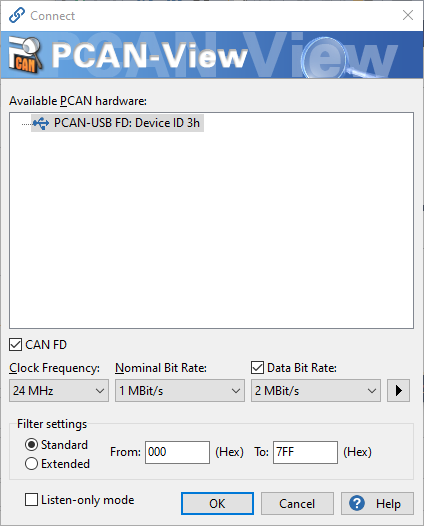

That's the config in the PCAN-View:
But when i start the program PCAN-View doesn't receive the message/data . Does anyone has a clue what i am doing wrong?

First, you have to check your bitrate config: Nominal & data:
