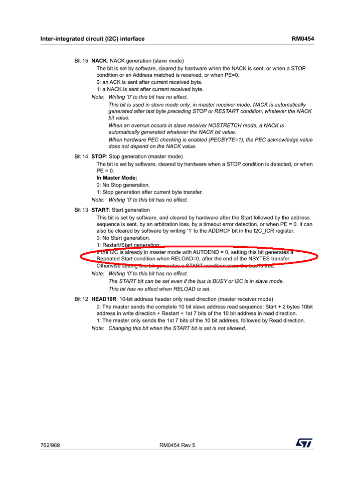

The described condition is called Repeated Start, and generally you achieve it by setting the START bit during the acknowledge phase. Details may depend on the particular I2C module (there are two distinct I2C implementations across STM32 families), e.g.:

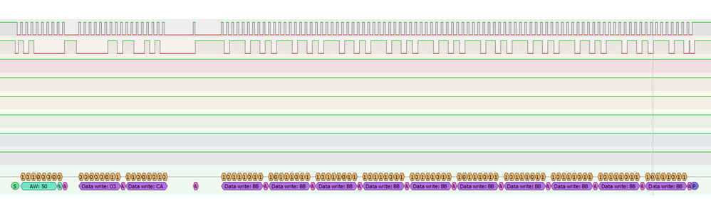

I have tried with HAL_I2C_Mem_Write function. In fact, I am using that function to write data to the fram. But I do not see the second start bit you mention:
I see the device address (First byte right after the START bit), 2 bytes for the place where the data will be stored and the data. After the data, the STOP bit signal.

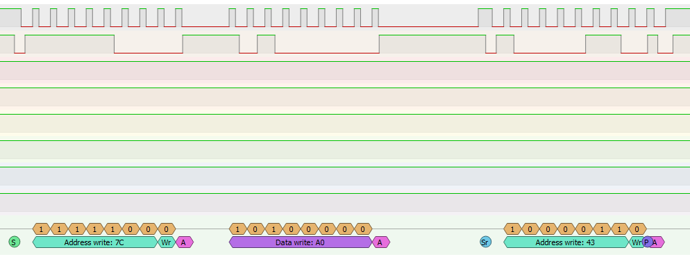

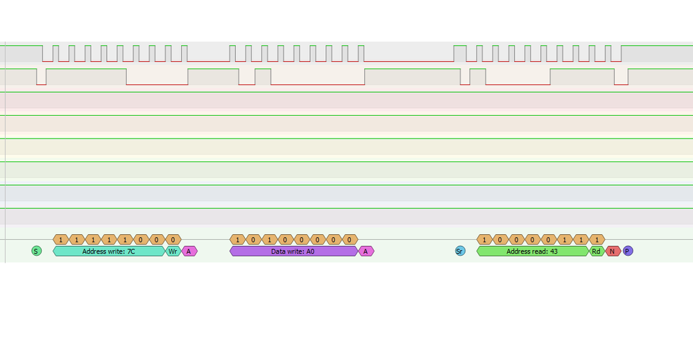

I think I am almost there but there is something I cannot get right.
In case I use a READ operation, I see the sequence fine but I receive a NACK at the end because of the bit flag changeg for the last byte:
0693W00000NsIy4QAF.pngAfter changing the READ operation by a WRITE operation:
The device sends the STOP bit before receiving the ACK from the slave. I cannot understand why this happens. Any idea? I am pretty sure it has to be a very silly issue.
Ok sequence for READ:
MODIFY_REG(hi2c->Instance->CR2, ((I2C_CR2_SADD | I2C_CR2_NBYTES | I2C_CR2_RELOAD | I2C_CR2_AUTOEND | (I2C_CR2_RD_WRN & (uint32_t)(I2C_GENERATE_START_READ >> (31U - I2C_CR2_RD_WRN_Pos))) | I2C_CR2_START | I2C_CR2_STOP)), \
					(uint32_t)(((uint32_t)sleep_command_2) | (((uint32_t)hi2c->XferSize << I2C_CR2_NBYTES_Pos) & I2C_CR2_NBYTES) | (uint32_t)I2C_AUTOEND_MODE | (uint32_t)I2C_GENERATE_START_READ));
Wrong sequence for WRITE:
					(uint32_t)(((uint32_t)sleep_command_2) | (((uint32_t)hi2c->XferSize << I2C_CR2_NBYTES_Pos) & I2C_CR2_NBYTES) | (uint32_t)I2C_AUTOEND_MODE | (uint32_t)I2C_GENERATE_START_WRITE));
