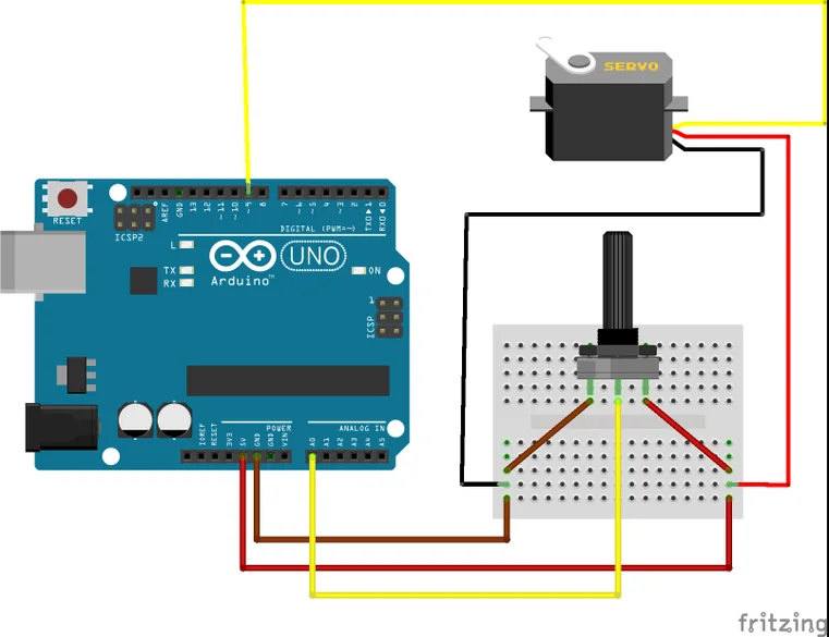

I'm using servo and driving it with servo motor. I want to print the servo degree via UART to serial. But im getting unknown characters. My code is;

I'm controlling the servo with potentiometer. "potadc" means the value came from ADC of the potentiometer. "servopot" means potadc/6, the rating of the servo 0-170. I want to see the value of the servopot live when i change the potentiometer.
‎2020-10-28 2:08 PM
Yeah, I think we all understood that, but there's a problem with the UART configuration and your hardware, and your posts lack any salient details to be able to diagnose.
Diagram what you have wired to where. And specify the STM32 part/board in question, several thousand different things out there, no idea what you're working with.
Stick a scope on the signal and figure out why you've got the levels or baud rate wrong,
Will save everyone wasting hours on this..
‎2020-10-29 1:31 AM
I'm using STM32F070RB. My connections are nearly same with this Arduino diagram;
I'm using USART2 with asynchronous mode. I just changed the baud rate 9600bits/s. 8 bit word length. 1 stop bit. No parity bits. TIM settings are; 19 prescaler, 1000 ARR, PWM 500 Pulse. Clock speed at 1 Mhz.
