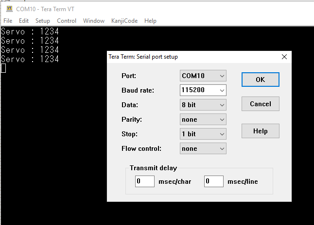

here my test, it works on my side with trace using TeraTerm.
main.c
#include <stdio.h>
/* USER CODE END Includes */
/* USER CODE BEGIN PV */
char str[16] = {0};
uint32_t servopot = 1234;
/* USER CODE END PV */
int main(void)
  /* USER CODE BEGIN 1 */
  /* USER CODE END 1 */
  HAL_Init();
  /* USER CODE BEGIN Init */
  /* USER CODE END Init */
  SystemClock_Config();
  /* USER CODE BEGIN SysInit */
  /* USER CODE END SysInit */
  MX_GPIO_Init();
  MX_USART2_UART_Init();
  /* USER CODE BEGIN 2 */
  int size_len = sprintf (str, "Servo : %lu\n", servopot);
  /* USER CODE END 2 */
  /* Infinite loop */
  /* USER CODE BEGIN WHILE */
  while (1)
  	HAL_UART_Transmit (&huart2, (uint8_t *)str, size_len, HAL_MAX_DELAY);
  	HAL_Delay(1000);
    /* USER CODE END WHILE */
    /* USER CODE BEGIN 3 */
  /* USER CODE END 3 */
Can you shareyour code (UART2 setup) and hardware you use ?

Set str before calling HAL_UART_Transmit(), and I think sprintf cannot use %d with unsigned long integer.
HAL_UART_Transmit(&huart2, (uint32_t)*str, sprintf(str, "Servo : %d\n", servopot), 0xFFFF);
Try:
uint8_t srt[16] = {0};
int size_len = sprintf (str, "Servo : %ld\n", servopot);
HAL_UART_Transmit (&huart2, (uint8_t)*str, size_len, HAL_MAX_DELAY);
32 would give you some margin, the %d could output 11 digits and sign, you need space for the NUL and newline characters​.
