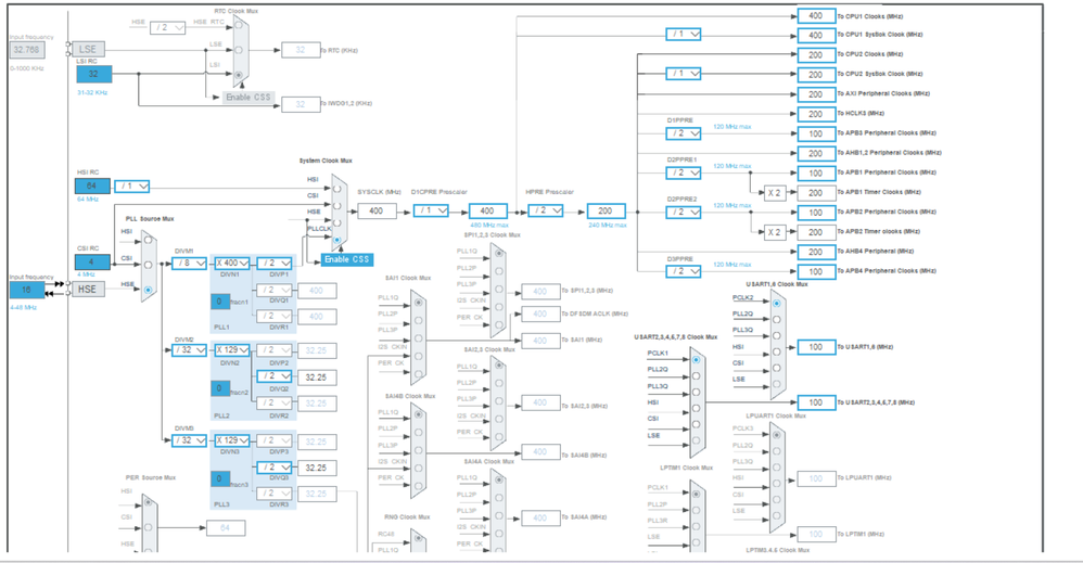

Hello Experts,

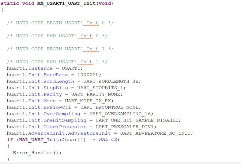

I am having problem with uart on stm32h755, nucleo kit.
I use uart1 and uart2 to communicate with each other using DMA.

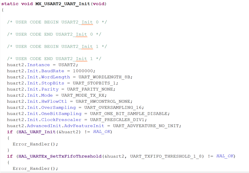

When I set the baud rate above 1M baud rate it doesn't work. Below is the clock configuration.Screenshot 2024-01-20 224149.png
And here is the UART configuration.
Looking forward to receiving any help.

How does "doesn't work" manifest?
The receive is problematic? The transmit? Over / Underrun?
If you transmit a constant 0x55 ("U") pattern, can you check the frequency with a scope?
As the rates increases the frequency error can get larger / rougher. You want a bus clock that's closer to a multiple of 16 MHz for 1 MHz, in 16 Over mode.
If using RS232 level shifters, these have bandwidth limits around 1 Mbaud.

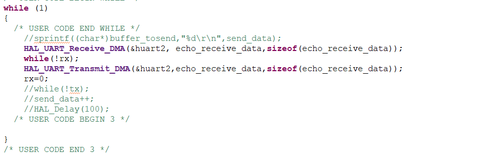

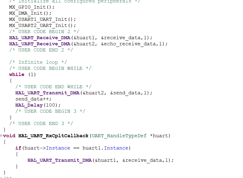

I just transmit from UART1 to UART2 and transmitted back.
Below is the code that performs the transmission and reception.
The problem is when I increase the baudRate to 2M the variables send_data, receive_data, echo_receive_data do not change. When I set the BaudRate to 1M, the variables change, proving that the UART is working.

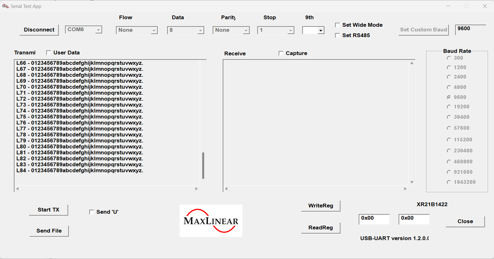

Ruồi
Hello F.Belaid,

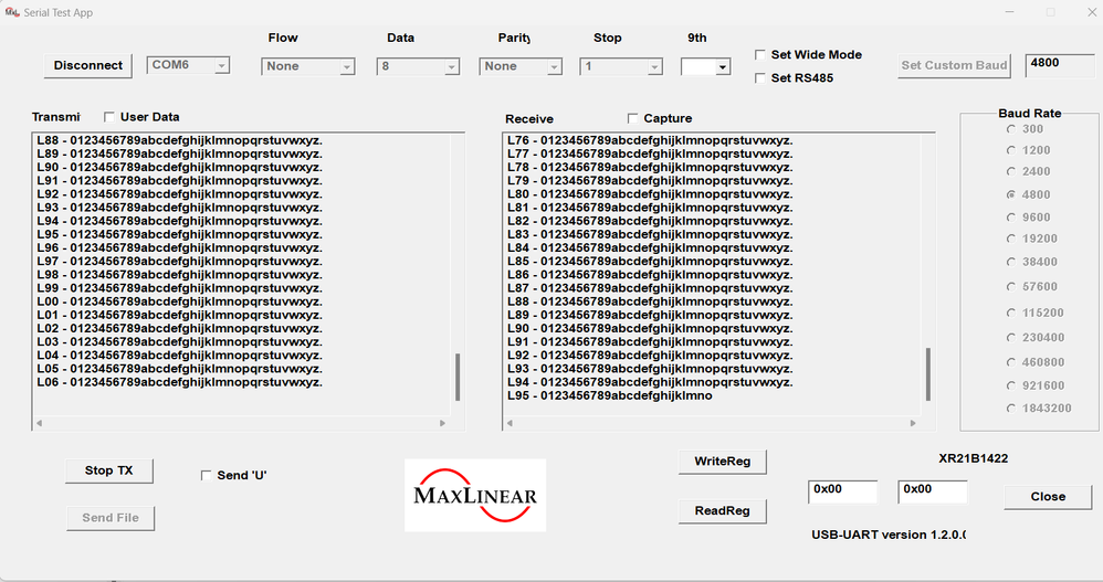

I tried using baudrate 9600 and connecting to Maxlinear's XR1422IL to transmit and receive to the PC.
However, another problem arose. That is, on the computer, the baudrate must be set half lower, specifically 4800, to communicate successfully.
Below is an image of unsuccessful communication between the H755 on the nucleo kit and the XR1422IL of MAXLINEAR, when the baudrate set on the software is 9600.
Below is an image of successful communication between the H755 on the nucleo kit and MAXLINEAR's XR1422IL, when the software baudrate is set to 4800.

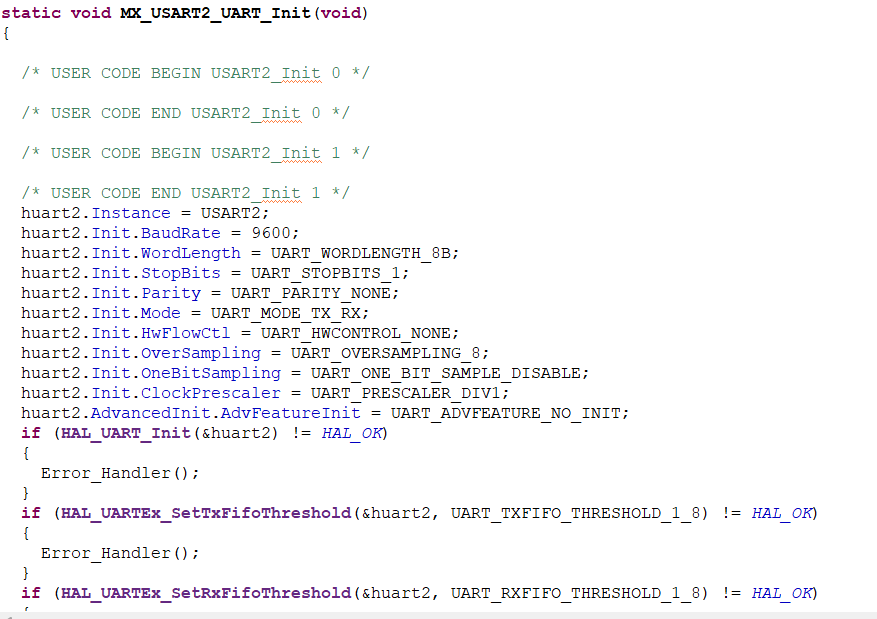

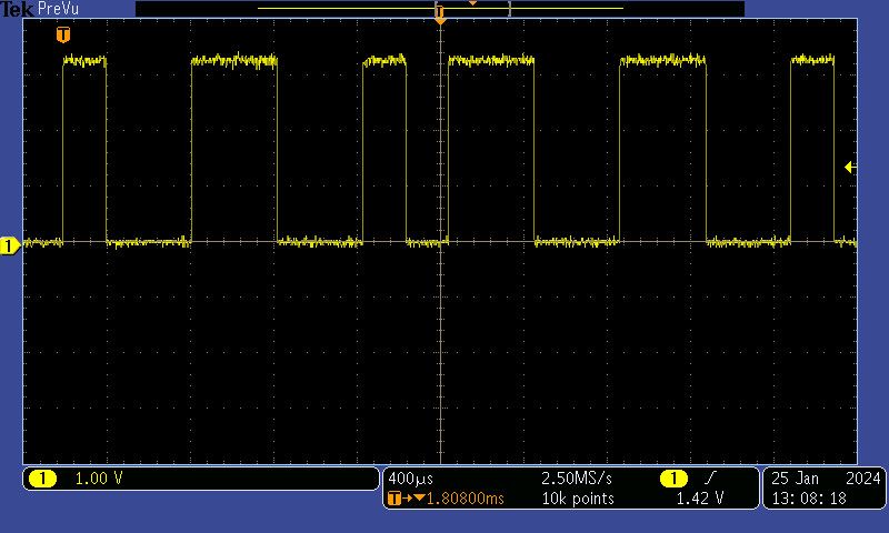

I also measured the TX pulse of the H755 but didn't find any problem.

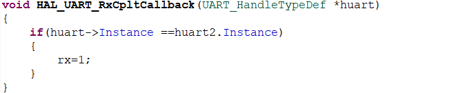

Below is the processing code on H755
Screenshot 2024-01-25 112651.pngScreenshot 2024-01-25 112724.pngScreenshot 2024-01-25 112759.png
