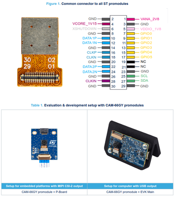

Good day,
I would like to use the STM32N657 Nucleo with a CAM-66GY camera (with the smallest lens), as the recommended B-CAMS-IMX camera is significantly too large for our application. I have seen the P-Board listed on the ST website as an adapter for the CAM-66GY. Does this adapter board convert the 30-pin connector on the flat ribbon cable into a 22-pin MIPI connection that can be connected directly to the Nucleo board? If so, where can it be ordered? Apart from the image in the CAM-66GY datasheet I have not been able to find any further information about it. Is this camera already supported for the STM32N6 ModelZoo vision CNNs?
EDIT: I found the P-Board on Digikey
Thanks in advance.
