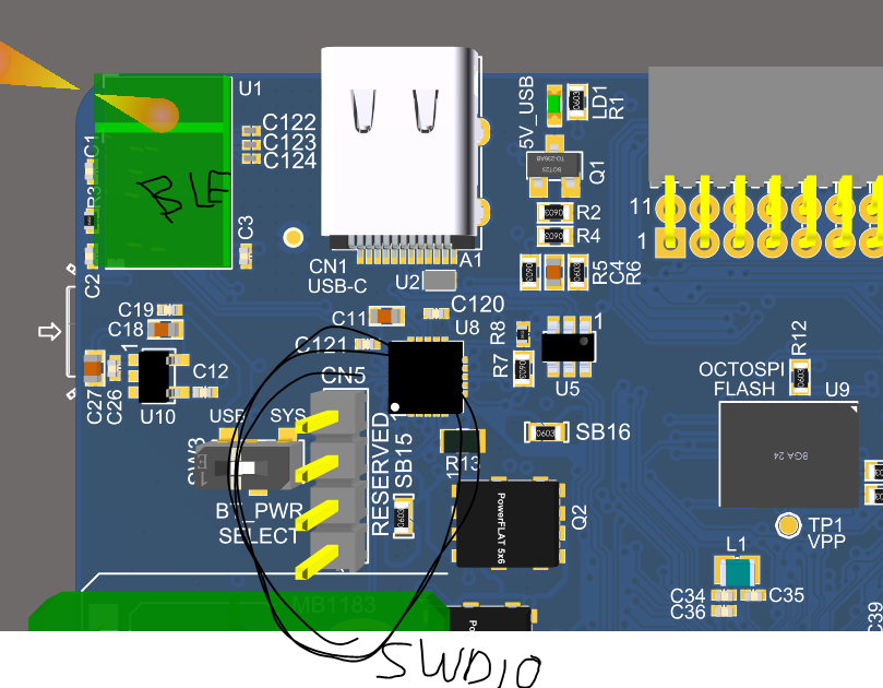

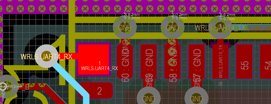

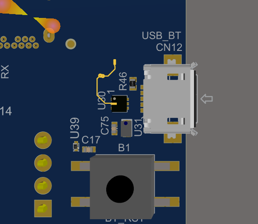

2023-02-10 5:00 AM
BLE is not Bluetooth Classic, is not trivial.
It looks like it the B-U585I-IOT02A has a STM32WB5MMGH6TR BLE module, i dont know if it comes with a preprogrammed ST example.
Even if it does i doubt its a plugNplay solution for your needs.
Anyway, it looks like it has a dedicated SWD connector, so you could use it to flash/debug some code in the BLE STM32WB5 module
With a quick look i can tell the STM32WB5 is connected to a USB connector, dont know if you need that
And is connected to the main STM32U585AII6QU processor trough uart4
