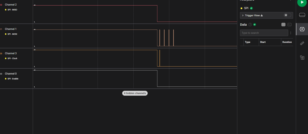

I use the STM32Lo538 disco board, and this board is connected to one sensor. Moreover, the protocol of this sensor is SPI. I faced difficulties receiving the data from the sensor. When I watched the waveform of this sensor, I noticed that the CS pin was driven from high to low, but data was not received by the master. Furthermore, I checked every possible condition, but still, data is not received by the master. However, I also tried the NSS pin, but this time I am only able to read one register and cannot read another register. What should I do?

Do you see SCK toggling when oscilloscope probing?
Does the number of clock pulse match the number of data bits transferred? Is the slave working in SPI 4 or 3 wires SPI mode ?
Yes, the number of clock pulses matches the number of data bits transferred , but sometimes not all the times .
slave is working in SPI 4 wire. My slave is the MAX30001 sensor, and this sensor is connected to the STM32 with the level shifter and buck converter because this sensor requires 1.8 volts.
figure , which is mentioned below has some change D3 line is basically MOSI and D1 line is CLK

As you use SPI 4 wires, it is better to consider that using SPI_TransmitReceive() function.
Extra dummy TX data to get all the needed clock bits (for reading), and RX buffer should be as big as TX buffer. If the transaction is 2 bytes to send and 8 bytes to read, make 2 buffers of 10+ bytes and use both buffer in the TransmitReceive function.
NSS is a pure GPIO not related to SPI, controlled by SW, in master mode (at least the way I use it).
