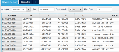

Few more information on the application that I am working on.
I have used the OCTOSPI1 and initialized it and used the MX25LM51245G APIs to perform the memory write.
Here is my code:

if (MX25LM51245G_PageProgram(&hospi1, MX25LM51245G_SPI_MODE,
MX25LM51245G_4BYTES_SIZE,
&data, 0x91000378,
sizeval) == MX25LM51245G_OK)
printf("reached here");
if (OSPI_NOR_EnableMemoryMappedMode(&hospi1) != 0)
Error_Handler();
/* USER CODE END OCTOSPI1_Init 2 */
The MX25LM51245G_PageProgram() API returns success message but I am unable to see the updated string in the external memory location through the memory browser window in CubeIDE. Also, the MX25LM51245G_BlockErase() and MX25LM51245G_ChipErase() does send the success response, but not clearing the specified memory block.
Is there something that I am missing here?

2024-10-22 9:34 AM
I got the hardfault handler when I set the memory mapped mode and tried to write into external flash using memcpy() API. I have not used that approach in my current application and I am trying to write into memory using the MX25LM51245G_PageProgram() API.
The size of the external flash is 64MB, 1024 sectors of 64kb sized blocks.

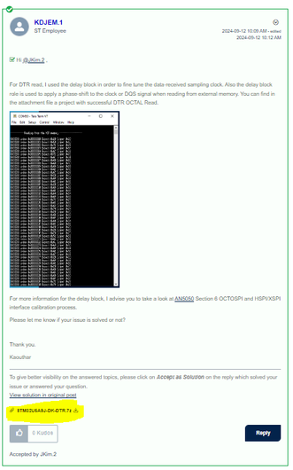

Hello @KDJEM.1 ,
I have already ran this example application in my board (STM32U5A9) and I was able to see the string in the memory location through memory browser. But my issue is, when I tried to incorporate the same changes in my project, I couldn't find any option to enable XSPI. The OSPI example doesn't work for me, so I thought I can incorporate the XSPI changes in my project and use the same methods in example to write into external memory. Unfortunately I couldnt find an option to enable the XSPI. I have even tried to manually copy the xspi.c and .h files from the example project, but that throws lots of error due to settings like (error: 'XSPI_HandleTypeDef' undeclared ), USE_HAL_XSPI_REGISTER_CALLBACKS etc, and it doesn't compile as expected. Can you tell me how to enable the XSPI in my project?
No XSPI option here to select:

Hello @RiverDi_user ,
The STM32U5A9 supports three interfaces (OCTOSPI1, OCTOSPI2 and HSPI1).
The STM32U5 HAL delivers both stm32u5xx_hal_ospi.c/.h and stm32u5xx_hal_xspi.c/.h files for customers.
- stm32u5xx_hal_ospi.c/.h: for OCTOSPI1 and OCTOSPI2
- stm32u5xx_hal_xspi.c/.h: for HSPI1, OCTOSPI1 and OCTOSPI2
When using STM32CubeMx for generation code:
* stm32u5xx_hal_ospi.c is used when OCTOSPI instance is chosen
* stm32u5xx_hal_xspi.c is used when HSPI instance is chosen
>but that throws lots of error due to settings like (error: 'XSPI_HandleTypeDef' undeclared), USE_HAL_XSPI_REGISTER_CALLBACKS etc, and it doesn't compile as expected.
->If you want to use OCTOSPI interface, you can used OSPI_HandleTypeDef and USE_HAL_OSPI_REGISTER_CALLBACKS instead of XSPI_HandleTypeDef and USE_HAL_XSPI_REGISTER_CALLBACKS.
I recommend you to take a look at AN5050 this application note explains the difference between Octo-SPI, Hexadeca-SPI and XSPI interfaces in STM32 MCUs. Also this application note provides many examples in section 7 OCTOSPI application examples can help you.
Thank you.

2024-10-24 5:59 AM - edited 2024-10-24 6:06 AM
Hi @KDJEM.1,
I am using STM32U5A9 variant (not discovery board) and the external flash is MX25LM51245G. I just checked this link you have shared yesterday and its similar to my issue. But I dont get the point, how changing from STMQUbe to Keil solved his issue.
I already have the https://github.com/STMicroelectronics/stm32-mx25lm51245g .c and .h files for the MX25LM51245G in my project, so I tried to utilize the APIs for reading and writing into the memory. I didnt receive any error, but it didnt write into the memory aswell.
Code example below
/* OCTOSPI1 init function */
void MX_OCTOSPI1_Init(void)
/* USER CODE BEGIN OCTOSPI1_Init 0 */
MX25LM51245G_Info_t pInfo;
/* USER CODE END OCTOSPI1_Init 0 */
OSPIM_CfgTypeDef sOspiManagerCfg = {0};
HAL_OSPI_DLYB_CfgTypeDef HAL_OSPI_DLYB_Cfg_Struct = {0};
/* USER CODE BEGIN OCTOSPI1_Init 1 */
/* Get Flash informations of one memory */
(void)MX25LM51245G_GetFlashInfo(&pInfo);
/* USER CODE END OCTOSPI1_Init 1 */
hospi1.Instance = OCTOSPI1;
hospi1.Init.FifoThreshold = 4;
hospi1.Init.DualQuad = HAL_OSPI_DUALQUAD_DISABLE;
hospi1.Init.MemoryType = HAL_OSPI_MEMTYPE_MACRONIX;
hospi1.Init.DeviceSize = 32;
hospi1.Init.ChipSelectHighTime = 2;
hospi1.Init.FreeRunningClock = HAL_OSPI_FREERUNCLK_DISABLE;
hospi1.Init.ClockMode = HAL_OSPI_CLOCK_MODE_0;
hospi1.Init.WrapSize = HAL_OSPI_WRAP_NOT_SUPPORTED;
hospi1.Init.ClockPrescaler = 2;
hospi1.Init.SampleShifting = HAL_OSPI_SAMPLE_SHIFTING_NONE;
hospi1.Init.DelayHoldQuarterCycle = HAL_OSPI_DHQC_ENABLE;
hospi1.Init.ChipSelectBoundary = 0;
hospi1.Init.DelayBlockBypass = HAL_OSPI_DELAY_BLOCK_BYPASSED;
hospi1.Init.MaxTran = 0;
hospi1.Init.Refresh = 0;
if (HAL_OSPI_Init(&hospi1) != HAL_OK)
Error_Handler();
sOspiManagerCfg.ClkPort = 1;
sOspiManagerCfg.DQSPort = 1;
sOspiManagerCfg.NCSPort = 1;
sOspiManagerCfg.IOLowPort = HAL_OSPIM_IOPORT_1_LOW;
sOspiManagerCfg.IOHighPort = HAL_OSPIM_IOPORT_1_HIGH;
if (HAL_OSPIM_Config(&hospi1, &sOspiManagerCfg, HAL_OSPI_TIMEOUT_DEFAULT_VALUE) != HAL_OK)
Error_Handler();
HAL_OSPI_DLYB_Cfg_Struct.Units = 0;
HAL_OSPI_DLYB_Cfg_Struct.PhaseSel = 0;
if (HAL_OSPI_DLYB_SetConfig(&hospi1, &HAL_OSPI_DLYB_Cfg_Struct) != HAL_OK)
Error_Handler();
/* USER CODE BEGIN OCTOSPI1_Init 2 */
/* OSPI memory reset */
if (ospi_memory_reset(&hospi1) != 0)
Error_Handler();
if (MX25LM51245G_AutoPollingMemReady(&hospi1,MX25LM51245G_SPI_MODE, MX25LM51245G_STR_TRANSFER) != MX25LM51245G_OK)
Error_Handler();
/* Enable octal mode */
if (OSPI_NOR_EnterSOPIMode(&hospi1) != 0)
Error_Handler();
uint8_t data[] = "my hubbell test str";
uint32_t sizeval = strlen(data);
//MX25LM51245G_BlockErase(&hospi1, MX25LM51245G_SPI_MODE, MX25LM51245G_STR_TRANSFER,
// MX25LM51245G_4BYTES_SIZE, 0x90FF0000,
// MX25LM51245G_ERASE_64K);
//MX25LM51245G_ChipErase(&hospi1, MX25LM51245G_SPI_MODE, MX25LM51245G_STR_TRANSFER);
&data, 0x91000378,
Error_Handler();
}I have given my API calls in the previous comments already. Please let me know if you need any further info to support this.
