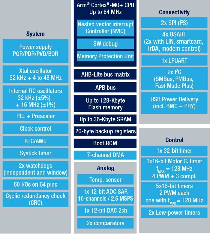

Note that the STM32 has to have multiple ADCs, this model you mentioned seems to only have 1 ADC (1x 12bits ADC). It would have to read one channel (ANALOG PIN) at a time.
https://www.st.com/en/microcontrollers-microprocessors/stm32g071rb.html

I believe there was a mistake, DAC is used to input a Digital value and output an Analog value. When the input is Analog and the read value is Digital, the ADC is used.
This channel part is really confusing, but it's like this: there are 16 input channels, but only 1 ADC. So this STM32 model has to read one channel at a time. For example this image of 1 ADC and 8 input channels:

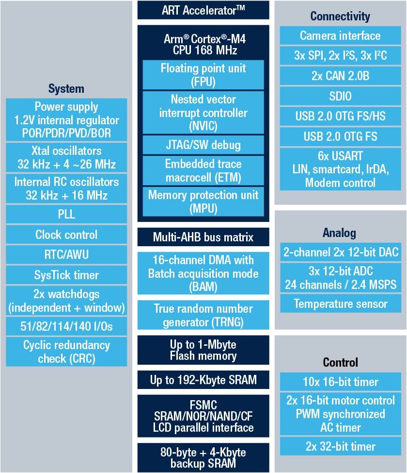

For example the STM32F405OE has 3 ADC and 24 channels. In this way it is possible to read 3 channels at the same time:
