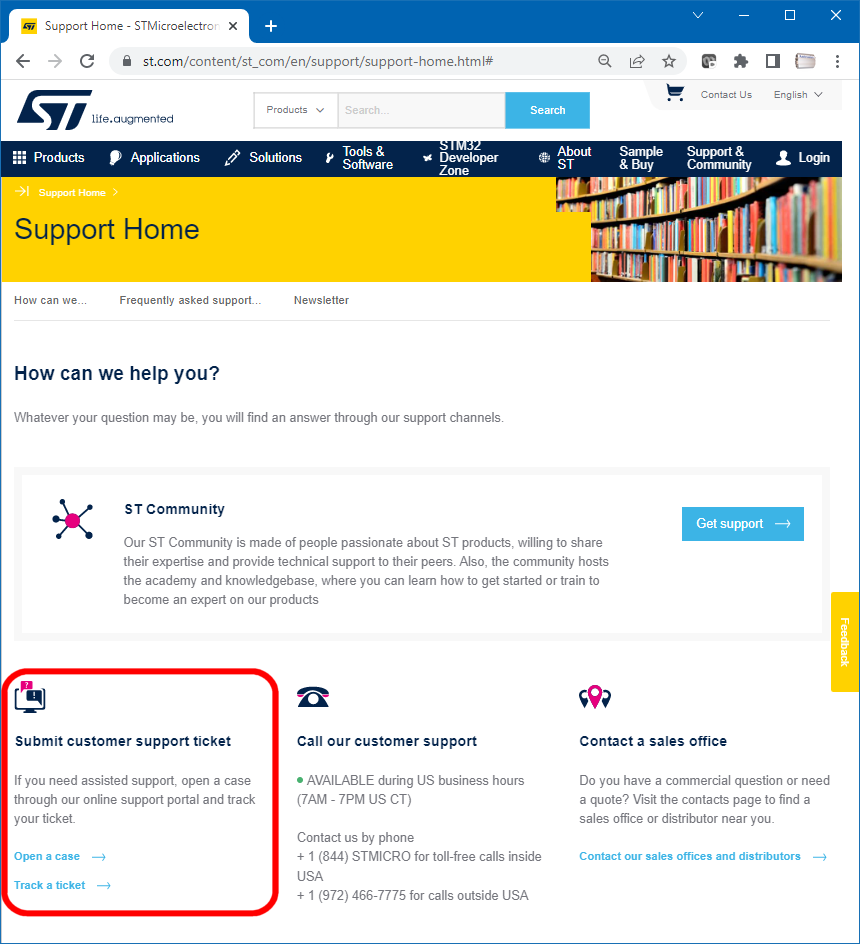

You'd likely want to talk to an FAE
There's also info in the ROM/OTP about the loader version number, and flash size tested.
I guess if you're digging at this you probably have some behaviour you're trying to attribute to the STM32 in the circuit. I'd probably focus on the power and discretes..
Andrew Neil
June 16, 2022
As @Community member​ said, you'll likely need to go direct to ST or your FAE for specific details of unpublished info like this.
