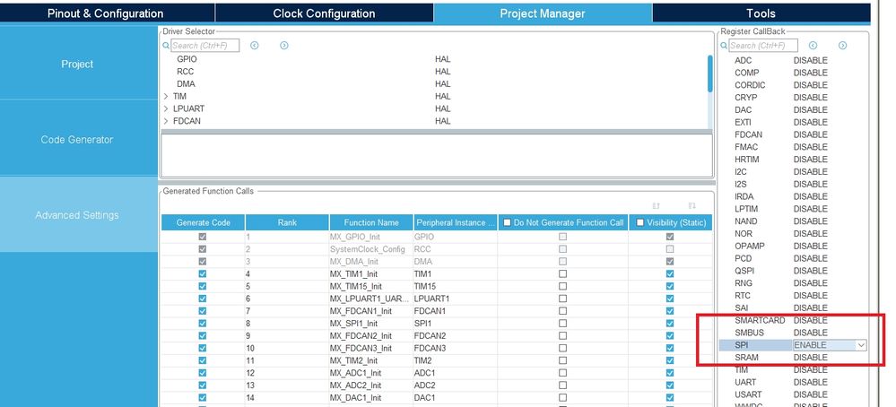

Writing software on the STM is like solving quests all the time. Unfortunately, in my experience there are more than TI or Microchip, for example. Lots of bugs even in rm that haven't been fixed for years
I managed to solve this quest in 3 minutes, I guessed that there should be settings in the cube
‎2023-04-28 1:05 PM - edited ‎2023-11-20 8:07 AM
‎2023-04-29 1:37 AM
as shown by AVasi , you can set REGISTER_CALLBACKS in Cube ;
you have to update Cube/IDE to newer version (IDE 1.10 or newer), to get this callback settings.
look, maybe you have it and just didnt know... or update.
‎2023-04-29 2:20 AM
yes, you are right, the cubmx configuration is now possible, even as it is not obvious where to find it.
the suggested #ifndef approach would allow switching configuration easily in code / during build -> cubemx as basline, further configuration e.g. by build profile (defines).

yes, there are many ways. some more manual, some more flexible, some more obvious, ... .
the cubemx ui tool is nice to get a easy start to setup a project, especially when using the eclipse (cube) ide.
some developers never leave the ide, never use cmake, never have parameterized builds. never use ci/cd, ... .
the file copy workflow can be done but becomes error prone fast when working in a team and committing in a common repo for the build.
different branches works -> may lead to a lot of merging for two or more branches that just differ in one or more defined values.
if cubemx would define ifdefs both approaches would still work and other (less manual /ui focussed) options would become available. the ifdef approach is not uncommon.
